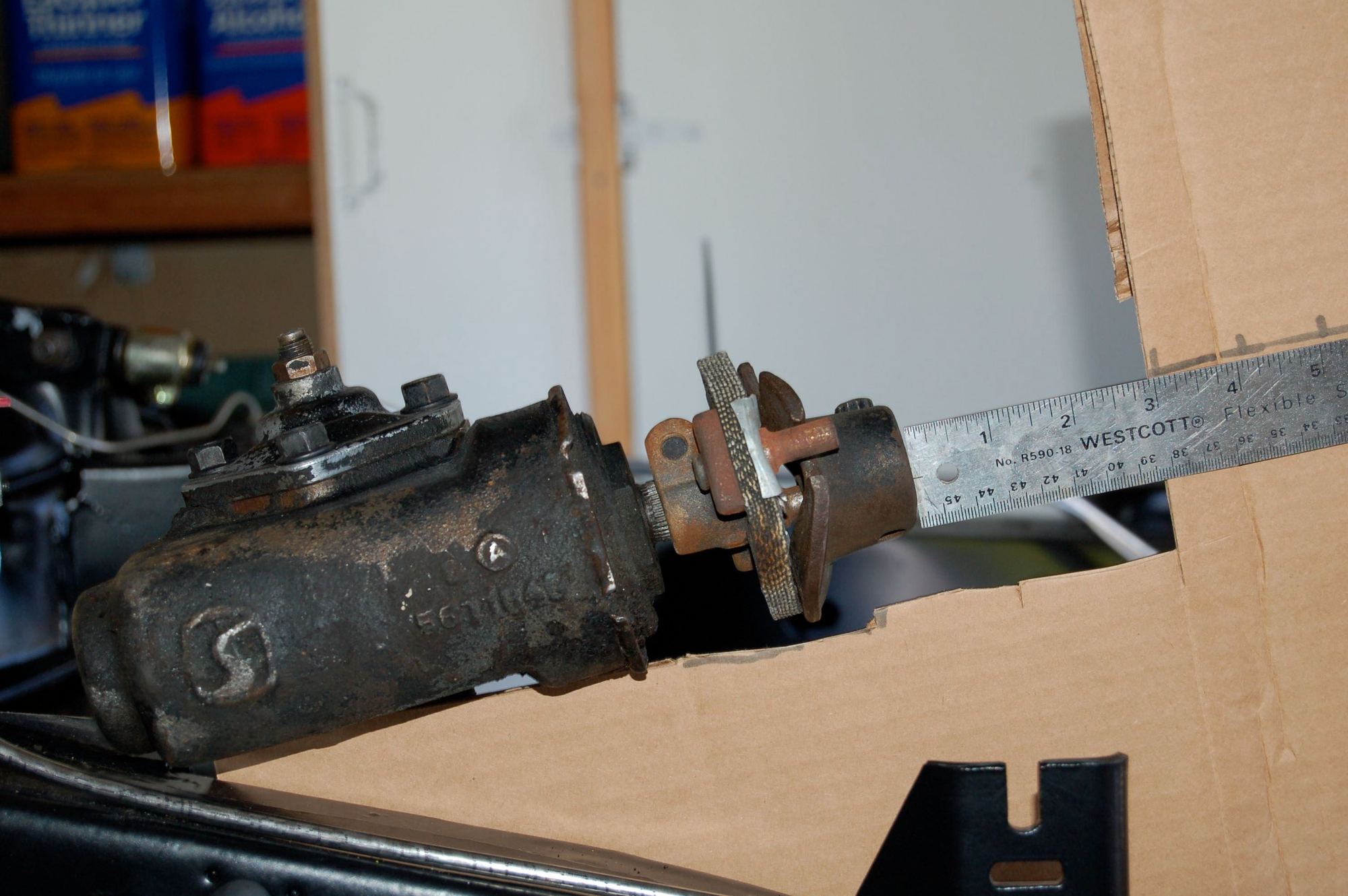

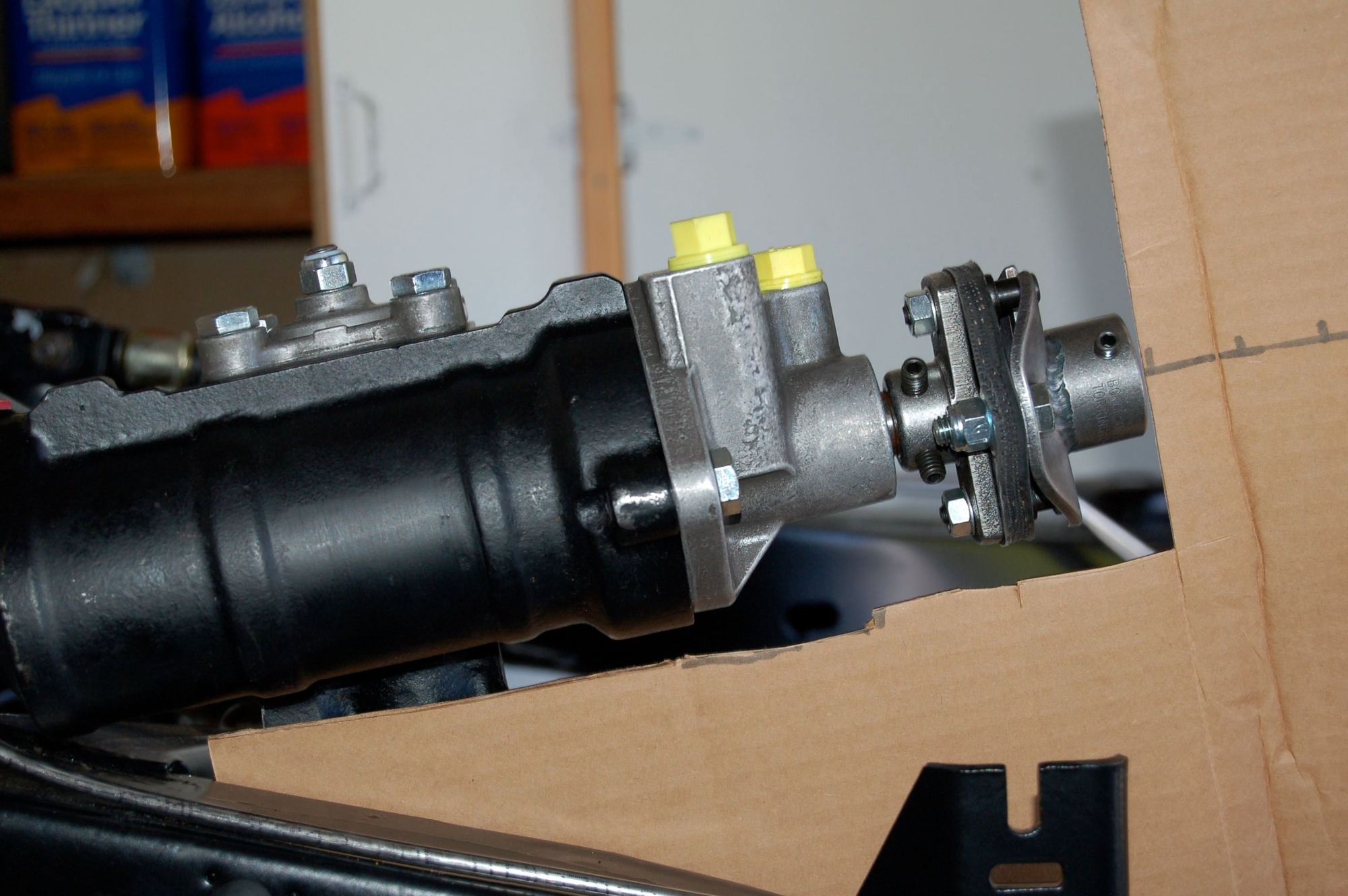

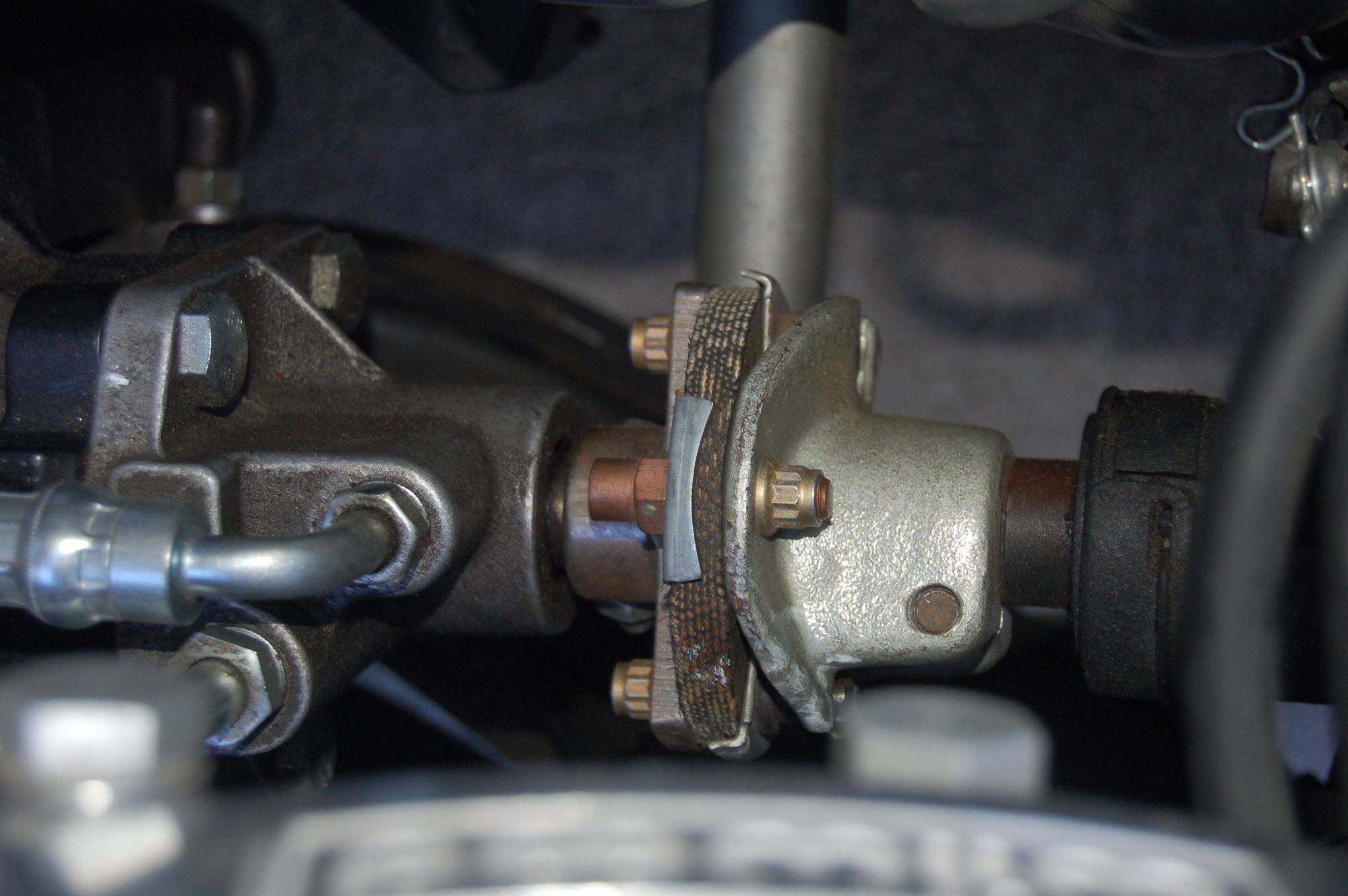

As it turns out, that question and also the shaft angle were on my mind when I was putting the chassis together. Here's a direct comparison
And in the coupler picture you can see that there's very little of the shaft exposed.
Thank you for those detailed pictorial. I planned on spray the shaft and the cavity with break free to assist, new system should be in wed.
