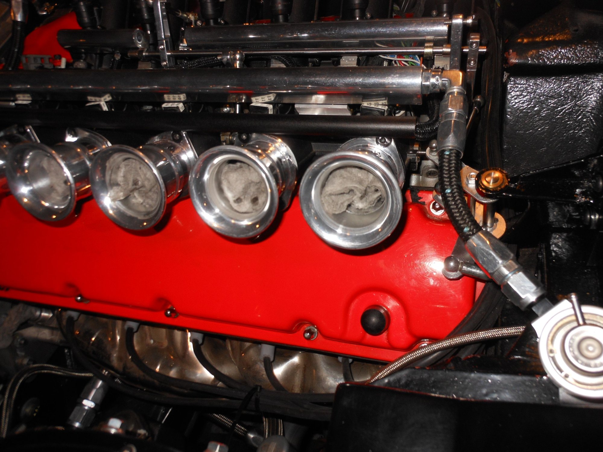

I'm running LS2/3 round type- and the way they are set up- leaves several options to making your own brackets.
Some threaded rod and aluminum tubing is one way-- then just use the valve cover bolts to hold the rod by making up a bracket. Just measure the distance between spark plugs and cut the tubing to space them.
not a SBC- but you get the idea
Then the thought was to use a Big bock valve cover to hide them
But after going to several car shows- I decided hiding them looked best-
Still used threaded rod- Only 12 coils to relocate!!!
Plenty of room on the firewall- running Vintage Air- and will make a fiberglass cover for them-
I definitely like the clean valve cover look-
