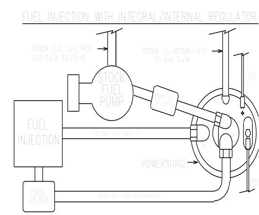

FiTech, Sniper, RobbMc all say that the original 3/8" would be fine. Now if you are huge horespower you'd want to move up to 1/2".
Here's a link to RobbMc Powersurge for fuel and rtn lines:
http://www.robbmcperformance.com/pro...owersurge.html

72Project, found a few pics that may help you.
Sniper with stock tank and rtn (#7 are -6AN)
Using a sump (FCC, Edelbrock, Powersurge, selfmade)
