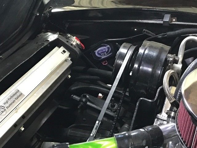

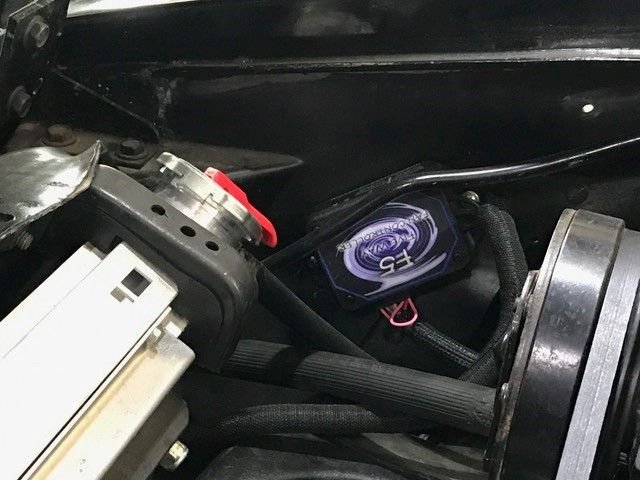

I have the Painless unit as well in my 1980 with DeWitts radiator. It mounted perfectly on the passenger side fender next to the filler neck. little heat and protected from water. I'll see if i can snap a pic tomorrow.

here are the pics of where i mounted mine. I did not hook up the speed controller since i have no electronics to connect it to. I removed the cigarette lighter and mounted the manual override switch there which is very handy.

Thank you for the pics. Definitely a good option.
I have to ask. The lower picture radiator hose. Is that what I think it is?
LOL, yes it is. It's a clear tube with heat shrink clamps. I thought it was cheesy at first but quickly learned how helpful it was in determining water flow when trying to get my controller dialed in. Between that and a infra red temp gun i have my controller dialed in just where it likes to be.
also, pay attention to where you mount your controller so you can get to the adjustment pots. They use a tiny phillips screwdriver tip and from what i read very delicate.
