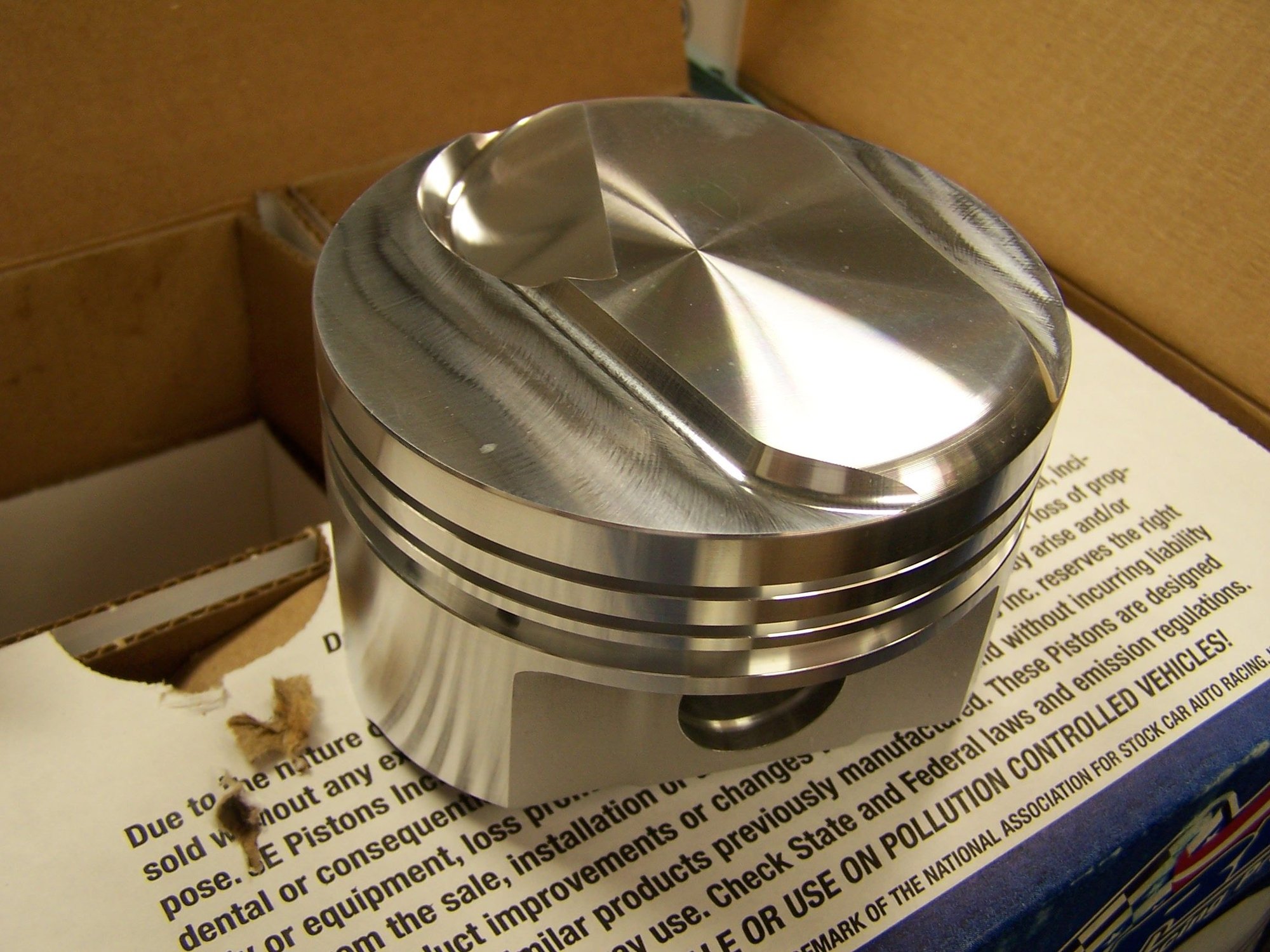

I rebuilt my OEM L-82 in 2014 when I had 66,000 miles on the motor. I went with a .030 bore, Forged JE Racing Piston/rings (I would not use Hyper's)...Total compression 10.2:1 with 9:1 JE pistons, Howards Roller cam (.525/.525 Lift, duration 219/225, LSA 110), AFR 180 aluminum heads and LTH's. I did reuse the L-82 forged rods, L-82 forged crank..reconditioned. The L-82 has very similar components to the LT-1's and the bottom is 4 bolt and all forged. Its a great motor with all the goodies for high performance. Go Roller cam all the way..forget a flat Tappet cam, in my opinion.
Had the L-82 355 out just today..holy smokes does it have serious b**lls after the rebuild..it simple amazing. BTW- I know what fast is, I have a 10C6Z06 for comparison.
