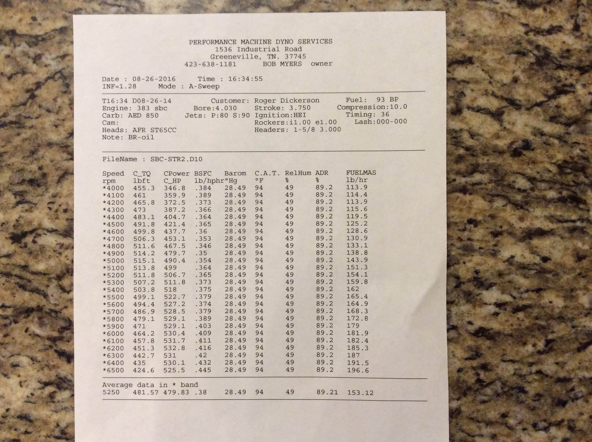

Pump Gas 383 Hyd roller engine with out of the box AFR195's. Airgap intake 850 Holley
What were the cam specs on this one?
Thanks
Dennis
Old Apr 3, 2017 | 03:38 PM
StraubTech's Avatar
StraubTech
Joined: Jul 2013
Posts: 1,299
Likes: 93
From: Tri-Cities TN
With a 1.6 ratio
.584/550
233/235
108 LSA

nice numbers!
With a 1.6 ratio
.584/550
233/235
108 LSA
Thanks Chris

Chris, that motor is really dialed in. Thumbs up!
Thank you. For a shelf stock parts build it turned out really well. It's going in a 66' Deuce....traction issues you think?
With a 1.6 ratio
.584/550
233/235
108 LSA
WOW....Those are impressive numbers. Congrats
I'm going to build a 383 for my 81 and I'm shopping for "recipes"
I'm thinking about a set of ARF heads and just need to figure our pistons and CR ratio. I have a late 90s 4 bolt roller block.
Are those the true cam specs or are they adjusted for the 1.6 rockers? Any on details on the build would be interesting to see.
Nice work
Nice work
Khibbs
We supplied the customer a BYO kit and he and a friend put it together. The cam numbers reflect the 1.6 ratio.
