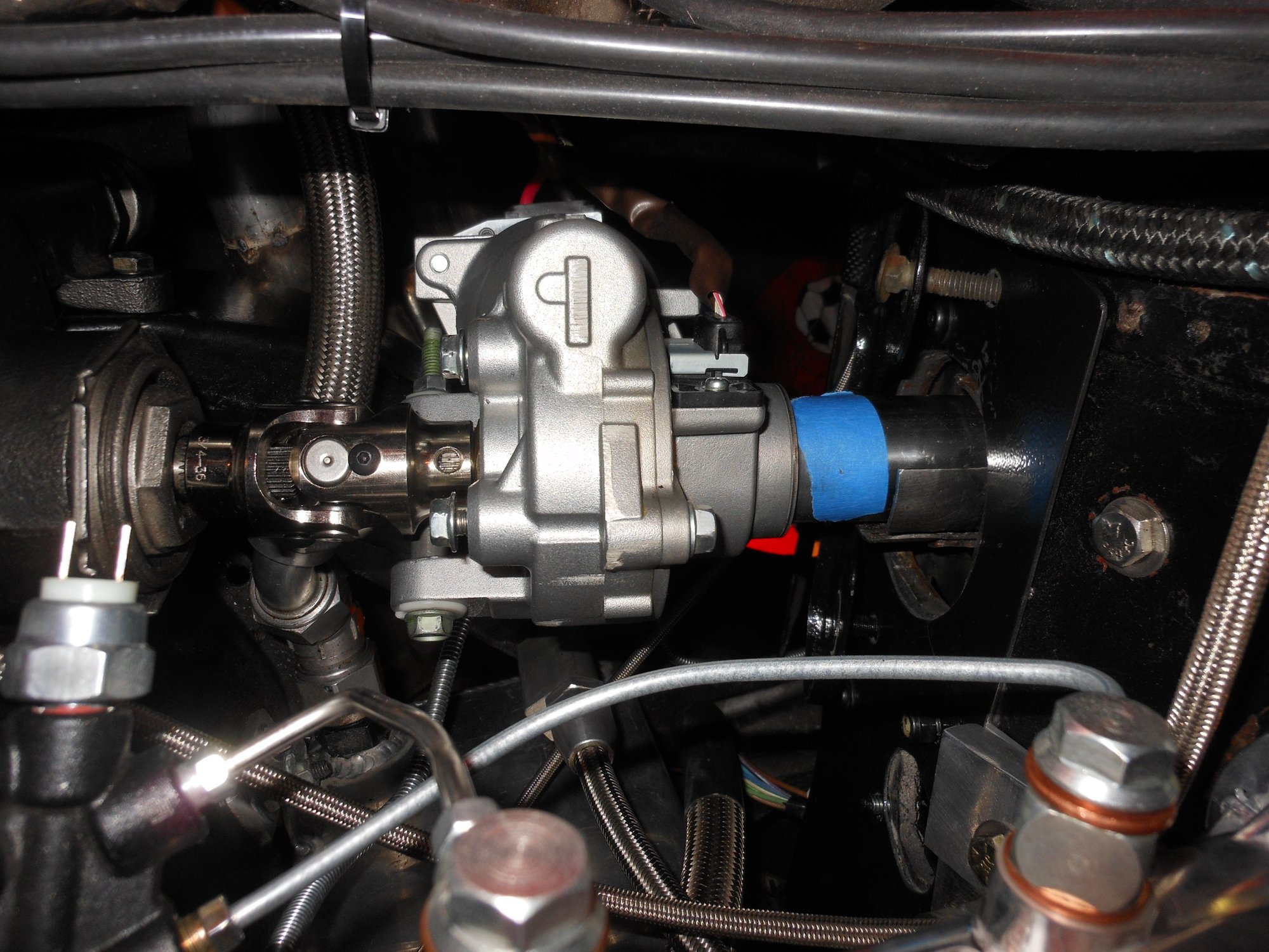

I'm going with an electric power steering mod-
There's a lot of kits that use the old Saturn piece. I went with a the newer one off a Nissan Cube. Supposedly the torque sensing is much better,
Was able to find a u-joint coupler for the application- HOWEVER the steering column will take a LOT of work. I don't think a tilt/tel column would work. Had to cut the Vette shaft and weld the Nissan piece to it.
There's NO room in he dash- where most of the motors are placed. AND going under the hood will only work if you're running a Hydraulic clutch or an Auto trans.
Here's the motor off the cube- also needed is the module not shown
Vette and Nissan shaft
