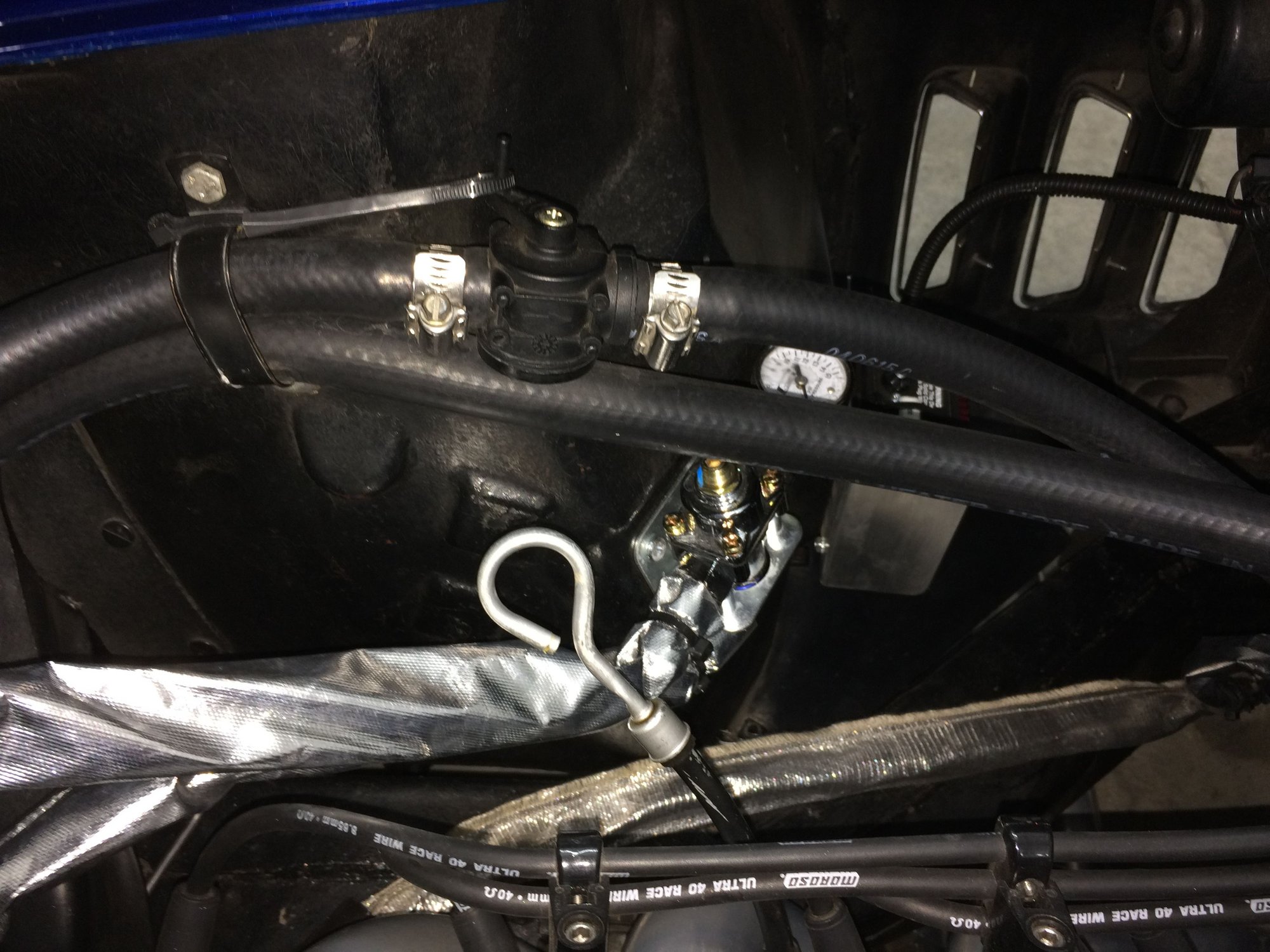

I do not remember what vehicle this valve was for but I it saw on a friends car and with a bunch of google searching I found it. Pretty compact. I use the zip tie to make sure it doesn't open during the summer. It at least blends in well.

That's pretty trick. Thanks. I wish we knew that part #.

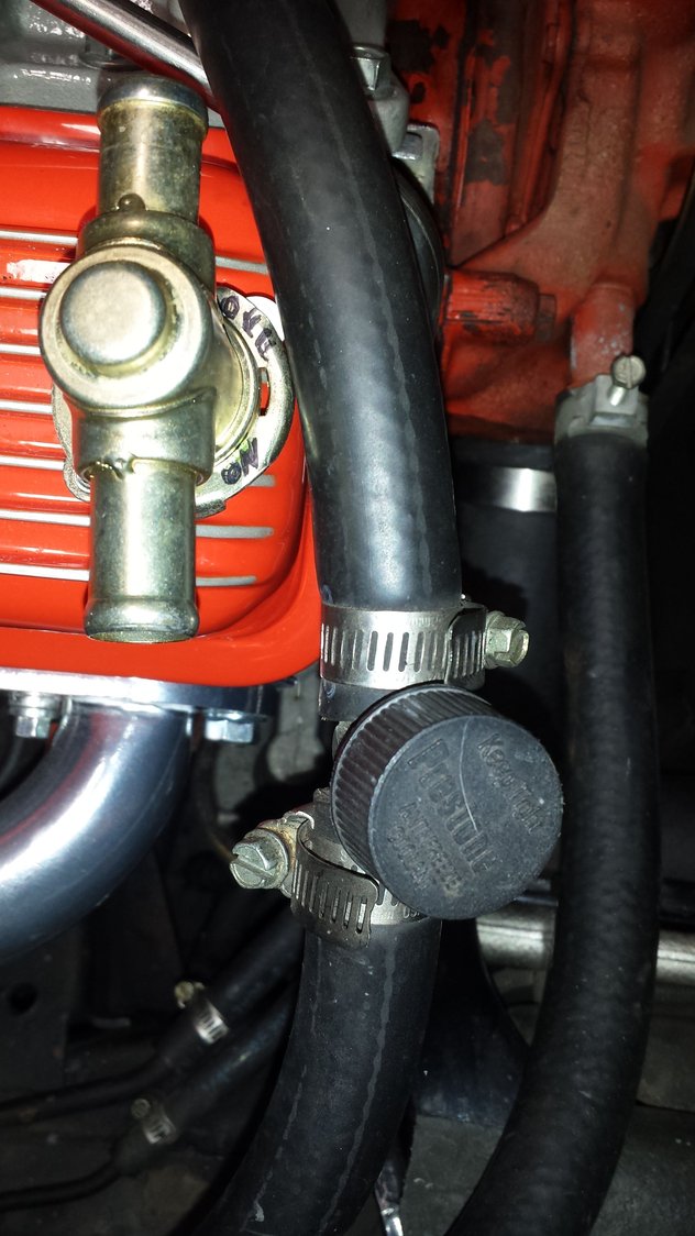

installed this on my 66, can tell the difference when i open it, leave shut during the summer , it is pretty compact in size and comes with a couple of different handles,

Likes: 1,028
That is sweet. Where did you find that one?
