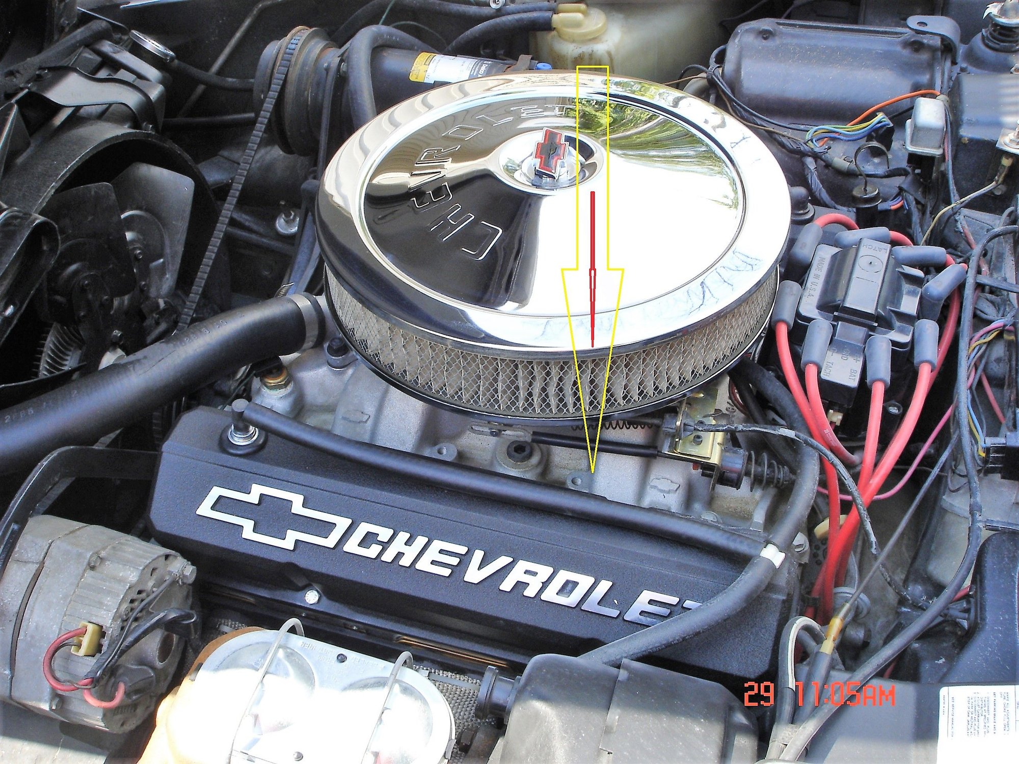

when looking for an engine you have to take into consideration your limited hood clearance, which means that engine would need a different intake than what is supplied which also means it will not put out the maximum power that is advertised.

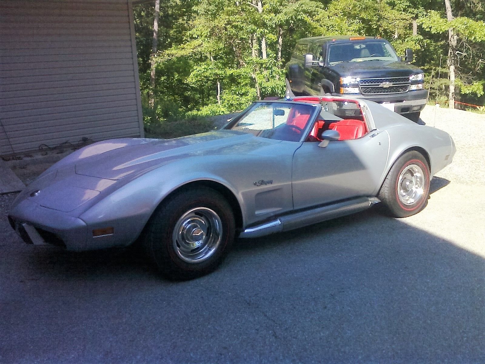

When I had my 76, I chose the fastburner motor from GM performance. I added the roller cam option which kicked the HP to 425.
RVZIO
Old Apr 14, 2017 | 07:47 AM
DerFammerwerfer's Avatar
DerFammerwerfer
3rd Gear
Joined: Apr 2017
Posts: 3
From: Charlotte North Carolina
RVZIO
Thank you so much. Your '76 is beautiful! Love the sidepipes - bet it sounds as good as it looks!
