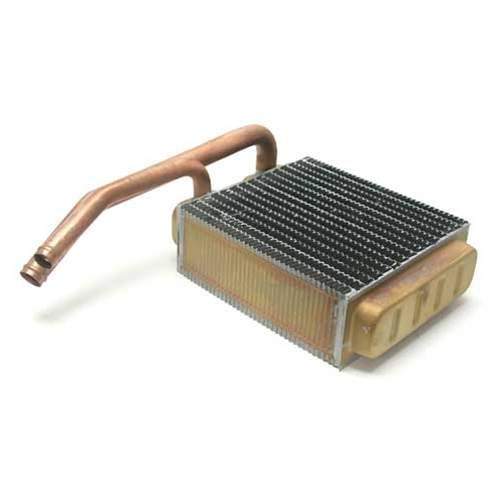

Old Apr 16, 2017 | 10:37 PM
Cavu2u's Avatar
Cavu2u
Joined: Oct 2013
Posts: 2,569
Likes: 126
From: San Diego California
The core.
I wanted to keep things OEM. I wanted to find a local radiator shop for the possible repair, but I CANNOT find a trustworthy radiator shop in this town! San Diego!
I therefore decided to replace the OEM core. This is what I got.
. ....... I'm returning it.
And I swear someone here said I could have fitment problems.
Anyone know of a trustworthy shop that repairs these? I believe DeWitts only manufactures, not repairs.
Thanks so much.
Steve

From whom did you buy the core replacement ? On Zip-corvette.com they have pictured one that looks identical to the original #M-324 priced at 79.99
You may call them and ask if the one they sell measures up to the original.
As for repair, seems harder to find the craftsman out there to do a lot of things today.
My replacement is an O'reilly's product.
Even the Zip one is an import unfortunately.
OEM. HARRISON, A73 stamped. I really wanna fix & keep it caski.

HEATER CORE, W/A/C-REPLACEMENT STYLE
Paragon Number: 5770
GM Part Number: 3015145
Years: 1968 - 1977
Stick With Us Price: $71.10
photo courtesy Paragon Corvette Reproductions
https://www.paragoncorvette.com/p-35...ent-style.aspx
Good luck... GUSTO
