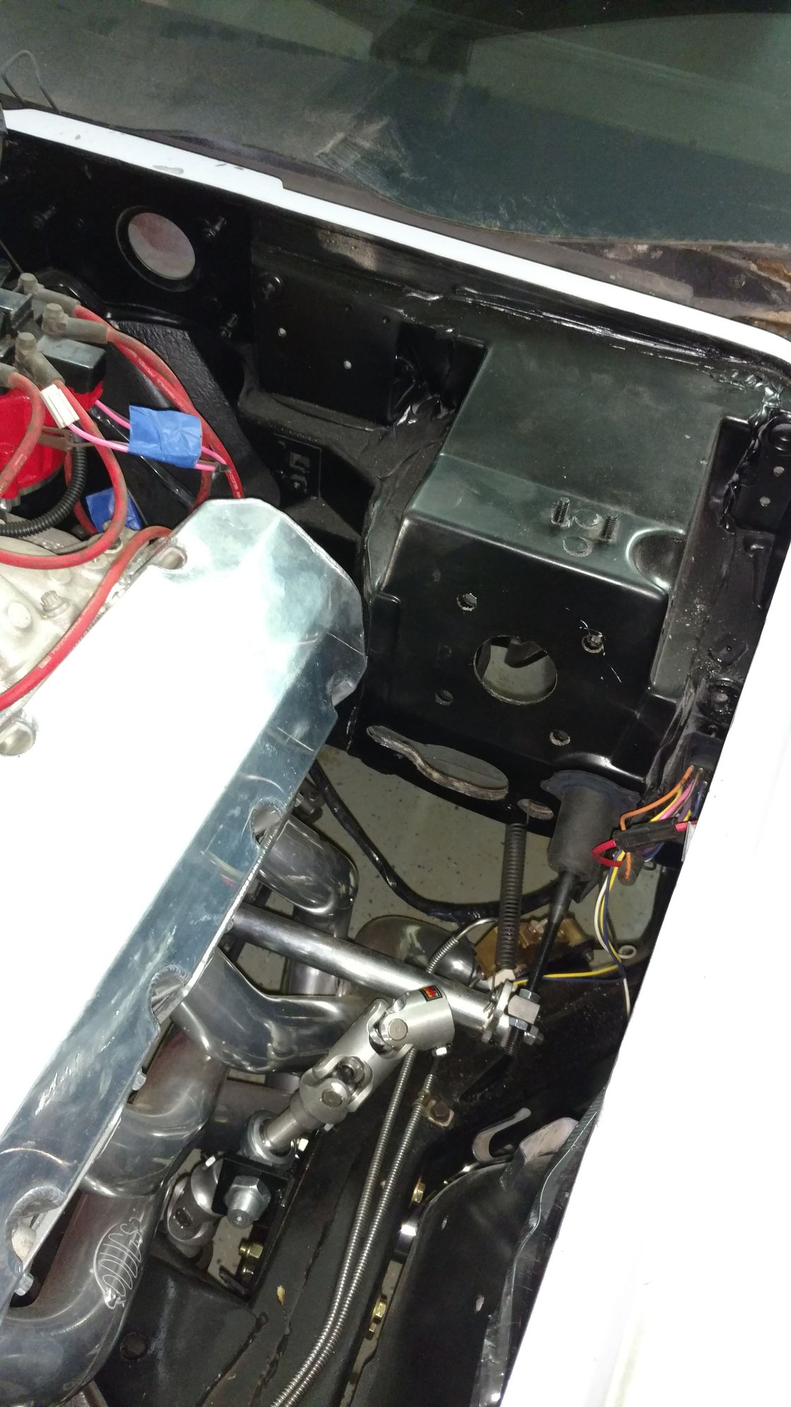

Just put body back on my 76 did a total redo on everything from frame and up Installed 454 bb actually 496 with 5 speed tremec.Dougs side pipe headers and steeroids r/ p. Now the problem.Power brake booster hits valve cover.valve cover on driver's side right up against body were booster attaches.Also noticed driveshaft is not centered in tunnel.

2 things , did you change the motor mount frame stands to big block stands? they are a little lower than small block stands. The other is tall valve covers and power brake boosters don't like each other. There is a stock left side cover for a bb w/ brake booster that is even lower in the rear corner.
I don't have any ideas on the trans not being centered, sorry.
Good luck

Installed big block springs and motor mounts.didnt change anything on frame

Tight against body no room for booster

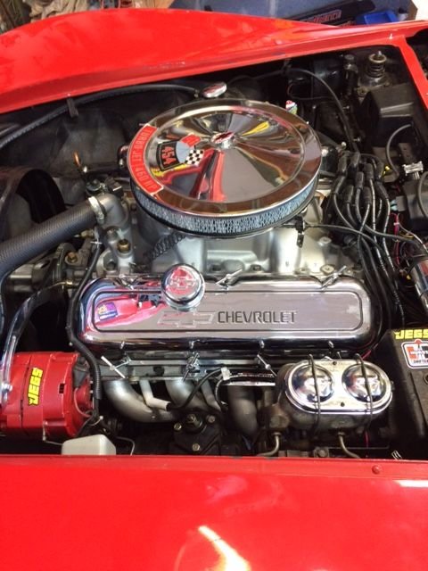

Yes- it is a problem. I have manual brakes and there is barely 1/4 inch clearance between my valve covers and the corner of the brake master cylinder mounting space.

I just used a pair of these covers on my 69 BBC with power brakes. It's close, but they do clear both the master and the T&D shaft rockers. Not from this vendor, but that gives you an idea.

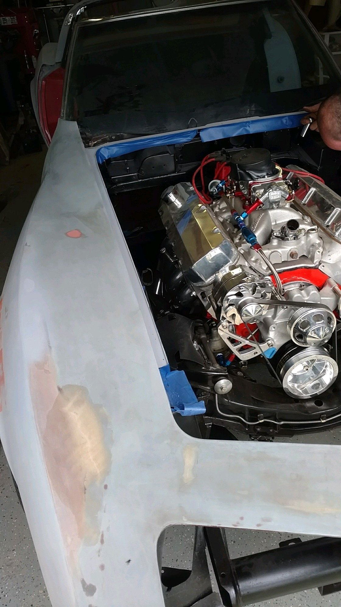

The driveshaft is NOT centered in the tunnel. The engine is offset to the pass side by 2". Motor mount stands are the same big or small block. Oh the joys of building a custom !

Do this. Look at how motor is sitting in the compartment and you may notice the tunnel is not the issue at all and the motor sitting on its mounts is allowing it to point towards the tunnel . My 4l80e install did that . So I pushed it off he tunnel wall and set the trans mount , tightnened her up and all was well for clearance. DO NOT expect centered in the tunnel it will favor pass side but if u ended up like me you will end up with about 1/2 clearance

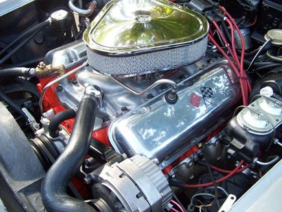

sorry your fancy valve covers are the problem,
your valve covers are much wider than stock, and taller.
thus clearance problems.
picture of normal width and height BB with Power booster,
and yes I am running Roller Rockers under them, tight fit.
