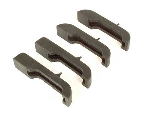

Are you talking about this cushions? There are several of them for later C3.
Yes.
