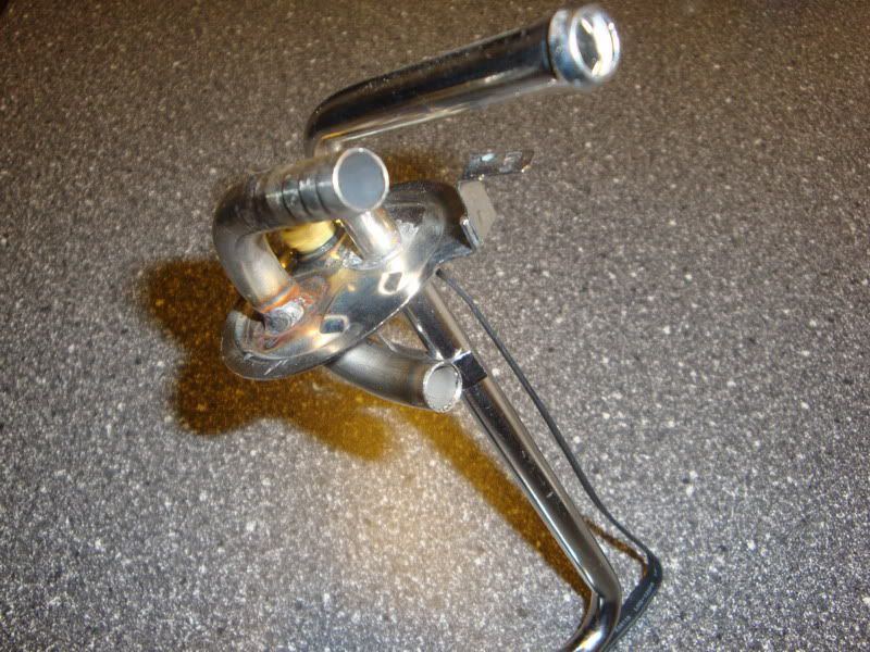

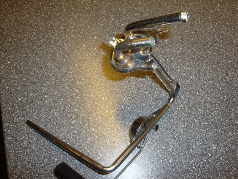

Going to put a FITECH go efi 600 on a 76. Not going to run the command center. Going to run a in-line pump from tank. Do I need to get a new tank or how do I make this one work? Thought about welding a new nipple at bottom of tank for supply and using the factory sending unit as the return but the tank has the rubber liner in it. Any suggestions?

'76 has a bladder in the tank so welding a nipple or sump on will not work. When I went EFI on my '75, I bought a new tank from Rock Auto and cut the upper ring off my old bladder to seal the top of the tank. I then used the Aeromotive Stealth in tank setup with an Aeromotive filter/regulator at the tank. I am using a -8 (1/2") AN feed line to the engine.
