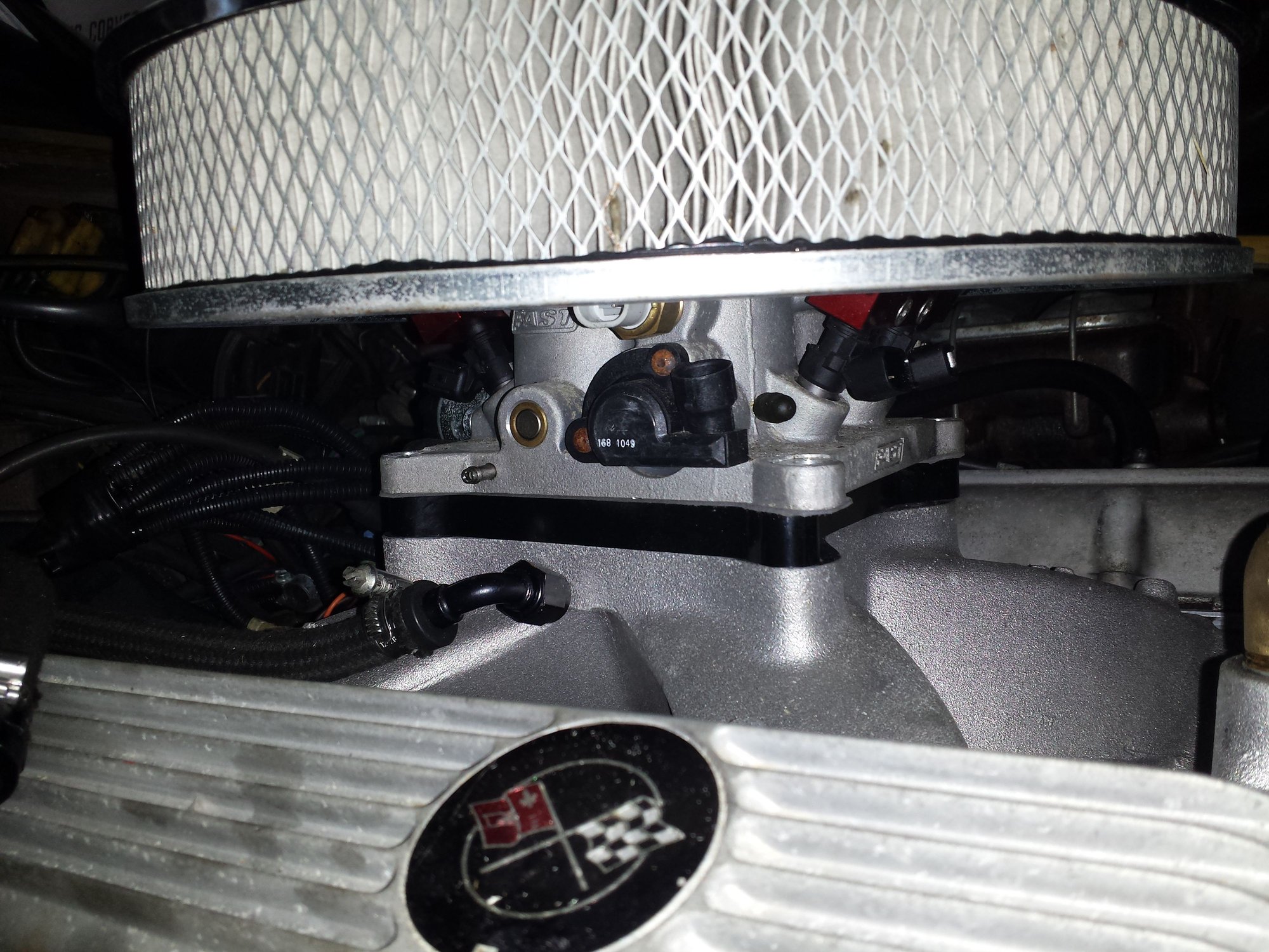

This is how it looks when I close the hood.
I have 4-5mm to spare/"use" :- )
