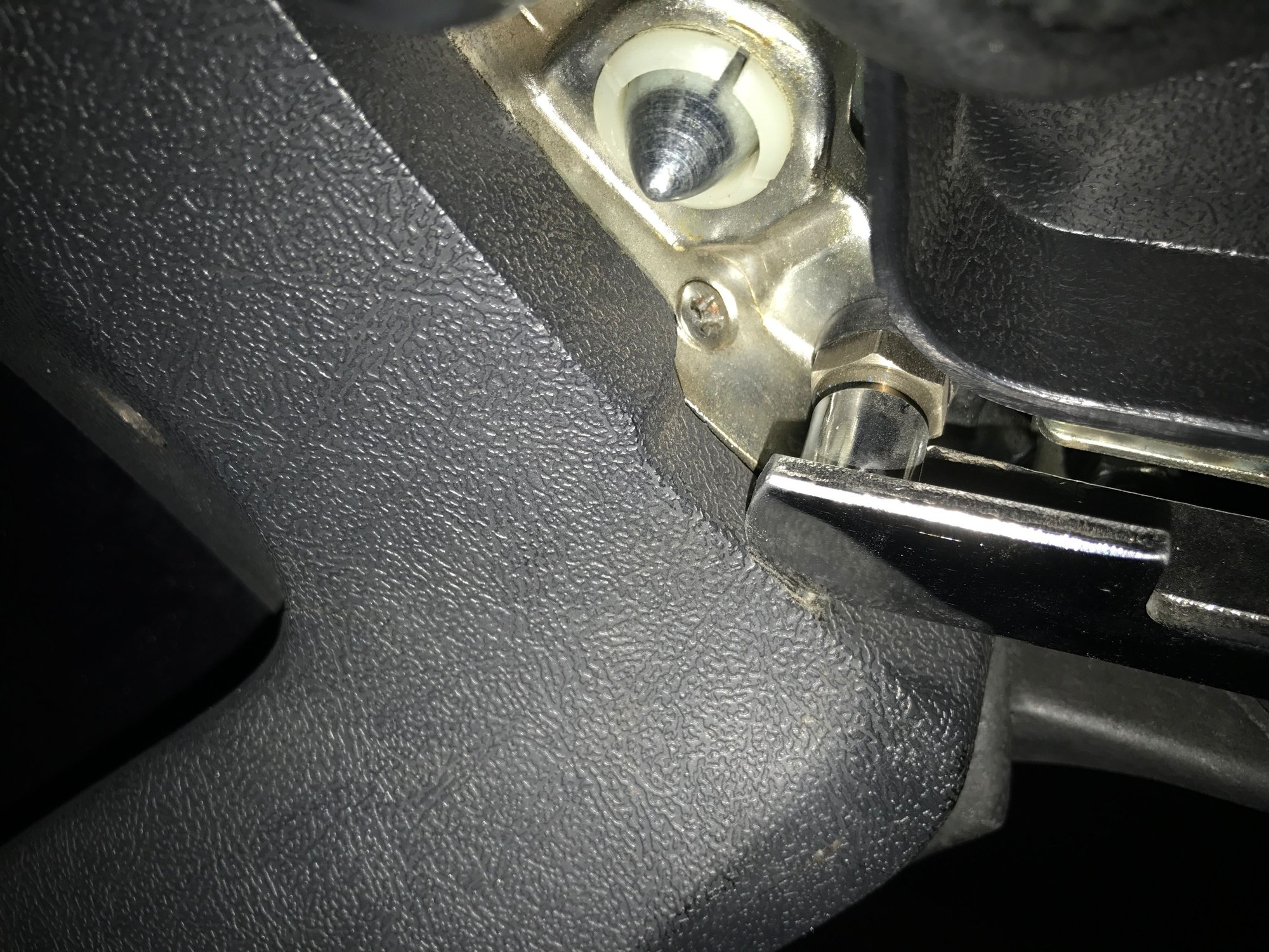

My glass t-top latches are touching and rubbing against the inner windshield pillar trim, has this happened to anyone else and are there shorter or different latches? If not I'm goint to have to grind the corner or the latches. Here's a pic:
The squeaking from the latches is driving me crazy!

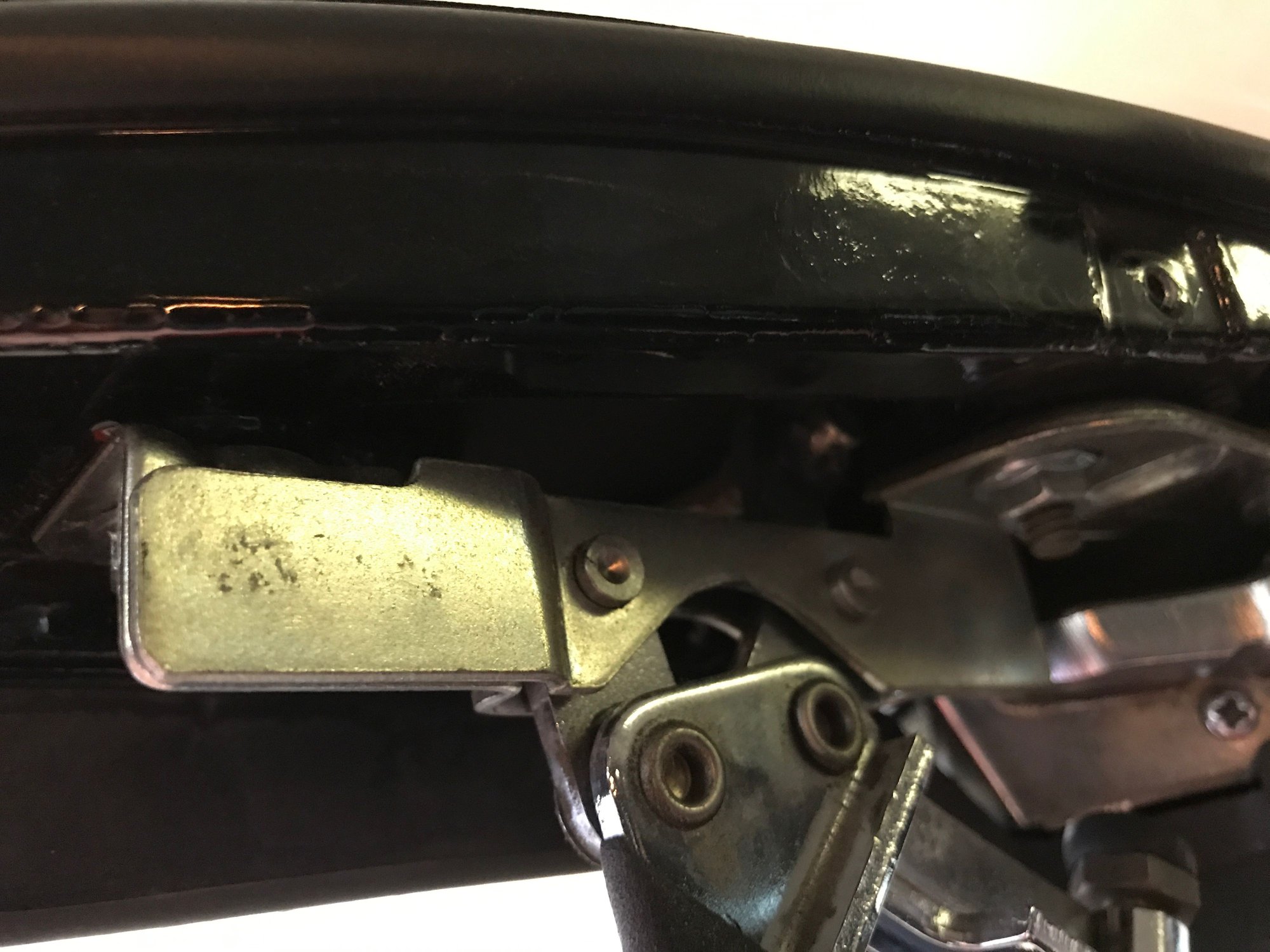

Hi IV,
There are 2 bolts that can be used to adjust the position of the latch.
The roof panel soft trim must be removed to access them.
Alan

So mine doesn't have that adjustment, I think I'm got to have to remove material from the latch where it rubs.

It's been a while when I did mine but I believe Alan was referring to the 2 nuts seen on your last pic. If you noticed, the bolt holes are oval allowing you to move the latch.

If only it was that easy! The latch is integral with the pin that goes through the windshield header, if I adjust the latch back the pin goes back too and misaligns the t-top.

Before you grind on the latch…. is it possible that soft trim isn't installed quite properly and it could be moved 1/4" to give you the needed clearance?

Mine touch about the same as shown in your picture but don't seem to squeak. I've had the car since new and don't remember them ever squeaking. Yours look like new trim pieces, maybe after they've rubbed for a while the squeaking will stop. Or maybe try a little graphite on the rub point?
