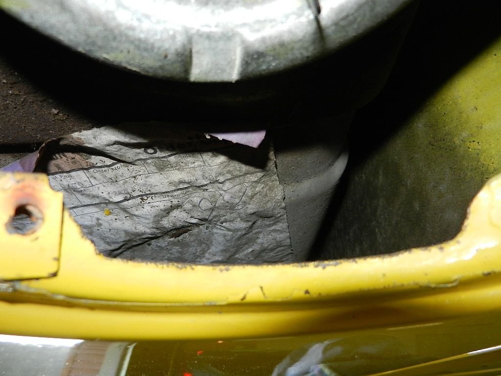

Here's an example of location….
This has it pretty close to the neck… but if it's on the other side of the neck it can be further away and difficult to…. especially if it's very dusty on top of the tank.
