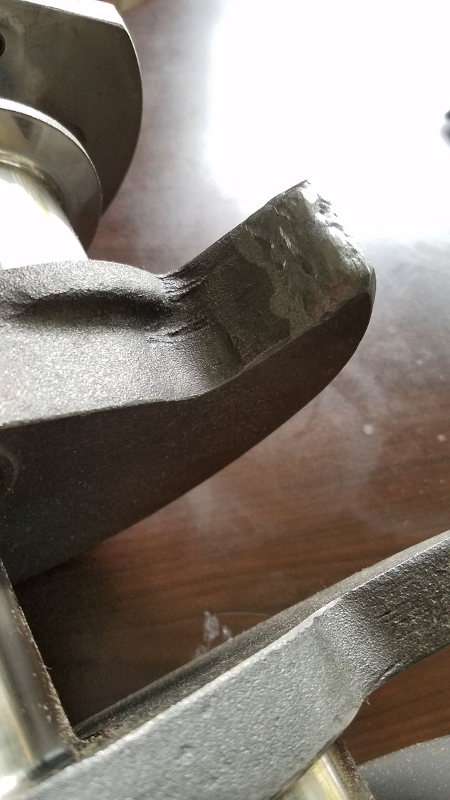

Any idea how/what/why this weld would be on a brand new BBC Scat Forged Crank?

Just a guess......to add weight
They needed a bit of weight to balance it.

Problem I see is that its the thrust surface. Looks like it has some scuffing on it. make sure weld doesn't hit the bearing surface

Not a thrust surface, it's a counterweight. Not going to hurt a thing.

Any weld protruding from a machined surface has a [potential] risk of interference with some other moving part. You just need to assess whether the protruding metal on that weld presents any risk to the engine's operation.
In general, that is a s4i++y weld to put on a finished part. Very cheaply done. A proper job would be to over-weld what was needed, bump grind to clean up protruding metal, then balance and REMOVE excess weld material from a risk-free surface.
I don't know who made that crank (or who balanced it, if it wasn't done at the factory) but it is shoddy work.

Where did you get it? Sure it's not a "second" that someone fixed? SCAT stuff is usually pretty nice. Are you sure it's SCAT? Some folks have been know to substitute others...

looks used to me

The usual method of adding weight to balance a crank is to drill and press in a tungsten insert (heavy metal) as the weight of tungsten is just over twice that of steel. For very small adjustments it's acceptable to weld it like that. Depending on pistons, pins and rod combinations crank weight sometimes has to be changed to get the proper balance ratio. That one doesn't look very sanitary but it is done on the back side of the counter weight and is not in the way of anything. If it was balanced with your pistons, pins and rods that would be why it's there. Basically, it was quicker than drilling a hole and pressing in a frozen tungsten weight.
You're right upon closer review of the picture I see the thrust surface is lower, down closer to the journal.
My mistake

Originally Posted by gkull
After having a 427 SBC light weight forged crank shaft break in the main bearing. I just started buying high end light weight cranks and never had another problem. both of my cranks are over $2000 each though. At the shop where i worked for 10 years most of the racing American V-8's had very expensive Bryant cranks
It was a 350 main bearing size and it had been balanced by taking out to much weight out of the rear most throw instead of weight out of several throws. So the person that did the balancing on the internally balanced rotating kit at scat or eagle is the one to actually blame
I would agree a 427 with a 350 main needs a good crank for sure...especially if you drive like you and me!! And definitely needs to be balanced correctly.
My crank has been through several rod/pistons assy's over the years and needed rebalanced. First was SCAT rods and SRP pistons. Then I went to Oliver rods (heavier) and Mahle pistons (lighter) and it needed a little more taken out of it. THEN...when I went turbo I used the Oliver rods and some Diamond turbo pistons (heavier). I had to add some weld to one of the old balancing holes to put it back in the right place. "Just a little dab'll do you". (OK...you're telling your age if you caught that last part).
