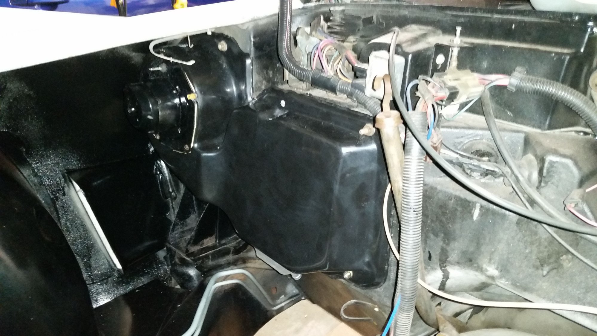

I need some guidance from Corvette Land. I bought and installed an AC delete cover to clean up the engine compartment and besides, the AC didn't work and this car is made for driving with the T tops off.
Anyway, after extensive work through the winter (new motor, brakes, suspension, steering, heater core, etc.), I realize I am missing the heater blower motor resistor.
I tossed the old AC stuff, including this resistor that mounted in the 'breadbox'. So, which resistor do I get, and more importantly, where is a safe location to install. I include a visual aid. I thank you in advance.

Hi,
The part you are looking for is the blower resistor.
https://willcoxcorvette.com/corvette...resistor-72-82
Here is how I installed mine using a 2 in hole saw.
Hope this helps.
John
