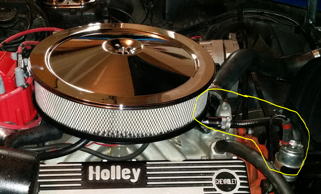

AFTER
BEFORE
Hi Swag,

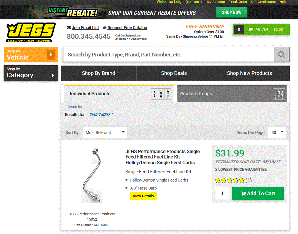

I used this line from JEGs which worked out great for me on my '69 SBC and Holley 1805 (single fuel intake).
I wanted to upgrade to the full sized air cleaner with the dropped base, and this interfered with the fuel line that was already in place (looked like a custom/cobbled job).
The new one has an inline ceramic (supplemental) filter, but the big enabler was the banjo fitting to the carb that allowed for a tight 90 degree drop right out of the carb.
I still connected with a short hose to the existing fuel filter, and may upgrade that at some point, but I got the set-up that I was looking for by using this line.
I only have a before picture with the Air Cleaner off.
The after picture just shows what is visible with the Air Cleaner installed.

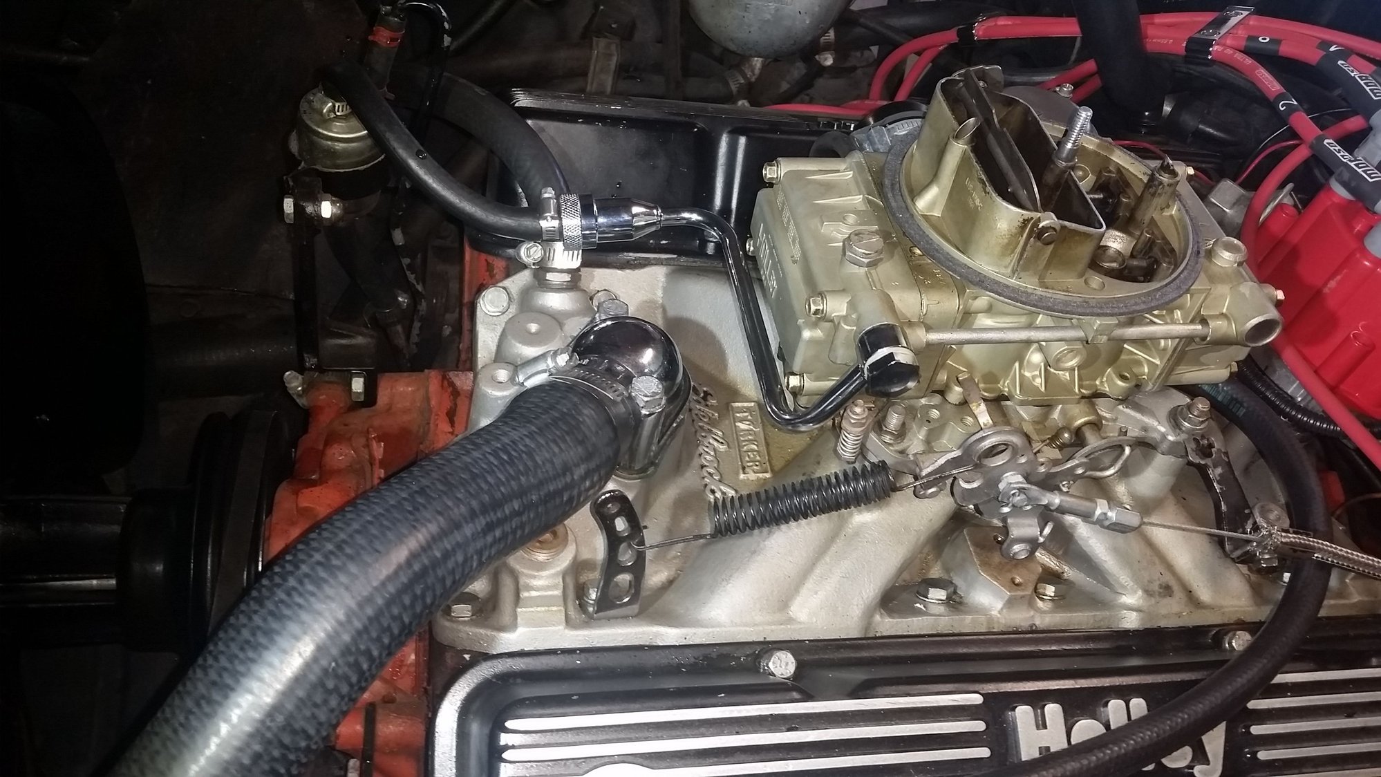

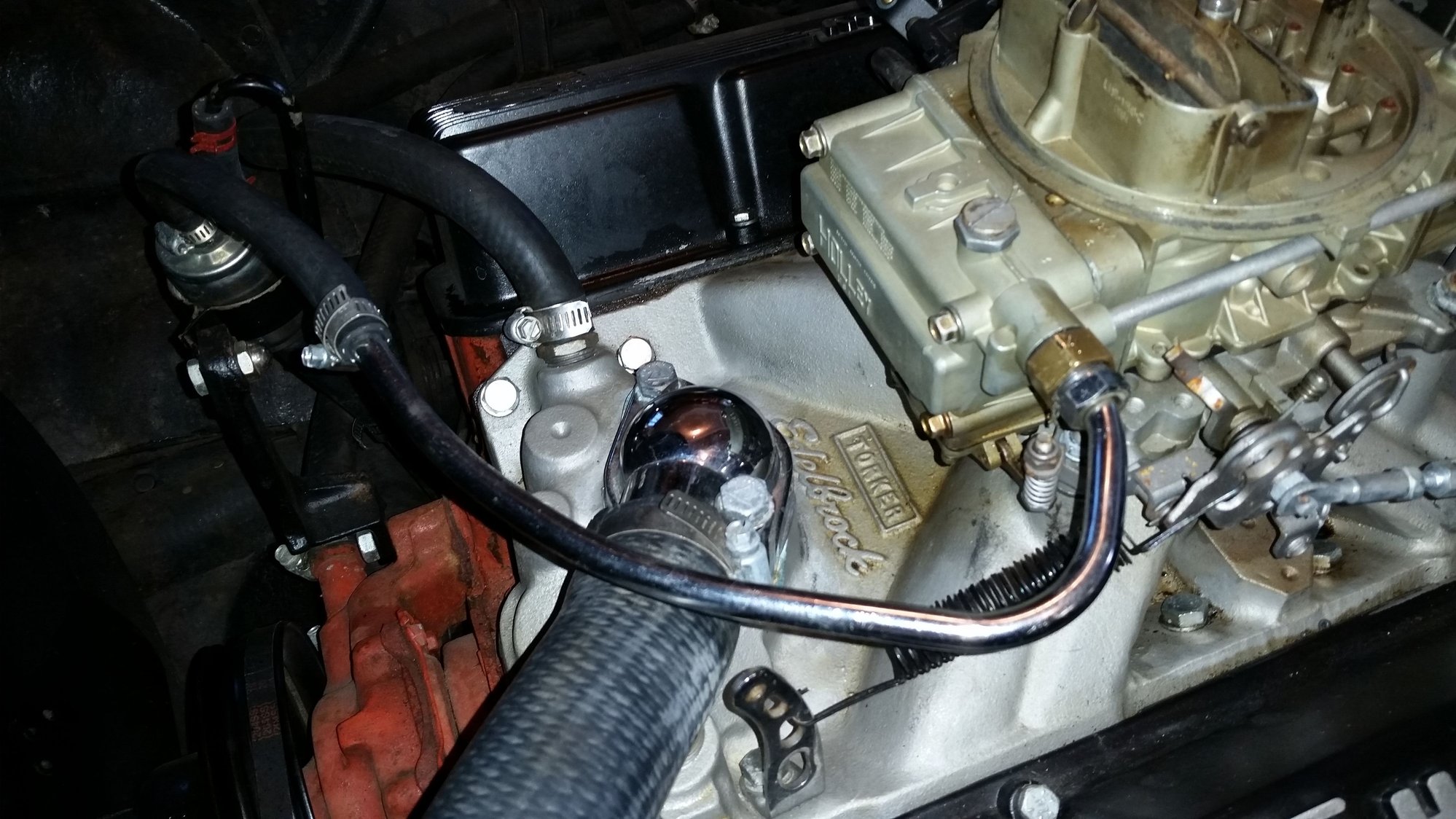

here's a couple of photos I took today
I just needed a short length of hose from the stock filter to the inlet of the new pipe at the supplemental filter.
Left side view
Top view
Old May 8, 2017 | 10:21 PM
swag's Avatar
swag
Joined: Jul 2016
Posts: 195
From: Littleton Colorado
Left side view
Top view
Thanks, that is perfect. looks so clean too.
I'm going to get me one of those!
