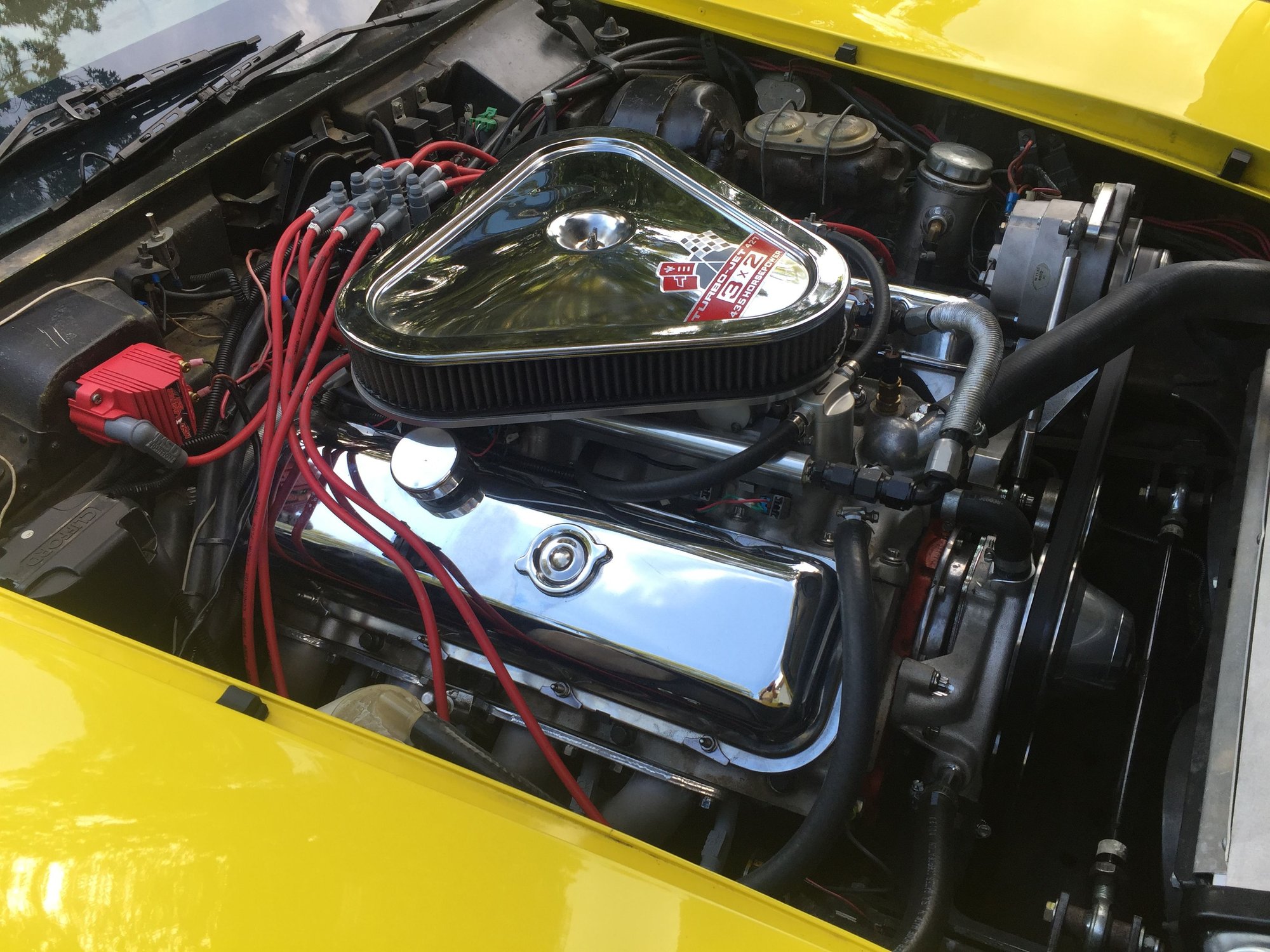

Oh ya, and here's a pic

I just looked at my pic and i know its hard to tell but my fuel pressure gauge is at like 8.5 in the pic. that was right after I shut the truck off. So i definitely need to dial back the fuel pressure before i go any further
