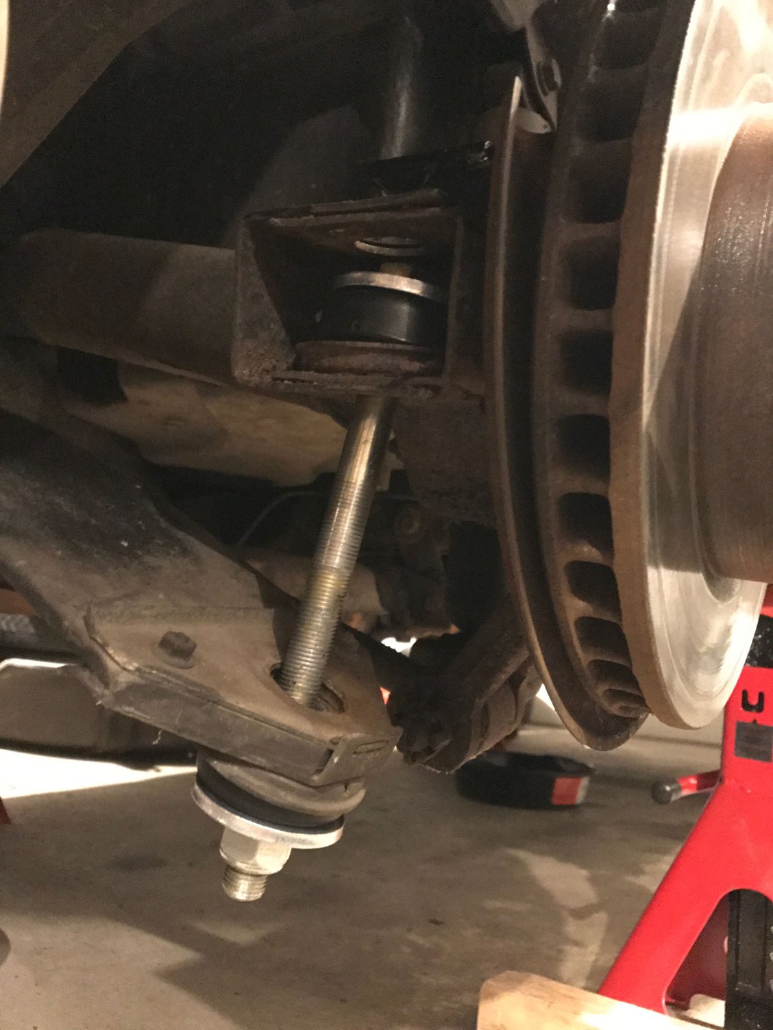

The PO definitely cut the front springs a bit on my 1981 and I've recently added 8" bolts to the rear to level her out a bit. I love the looks and the ride is decent. I'm not going for any major suspension upgrades at this point.
The rear shocks looked pretty spent to begin with but now with the rear a bit lower I've got one leaking.
