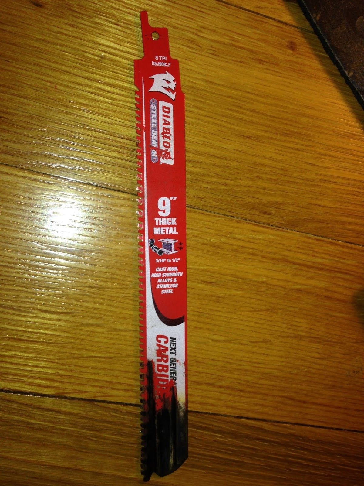

I think you have found the problem....Worn out trailing arm bushings. I just went thru this project myself and like you I'm a do it yourself kind of guy. It turned out nice and I have had no issues.
This ain't a job that can be done with just a set of hand tools.
If your bolts are rusted to the trailing arms at the frame don't even bother trying any other sawzall blade...Just get one of these.
Good luck with the project....
Brian
