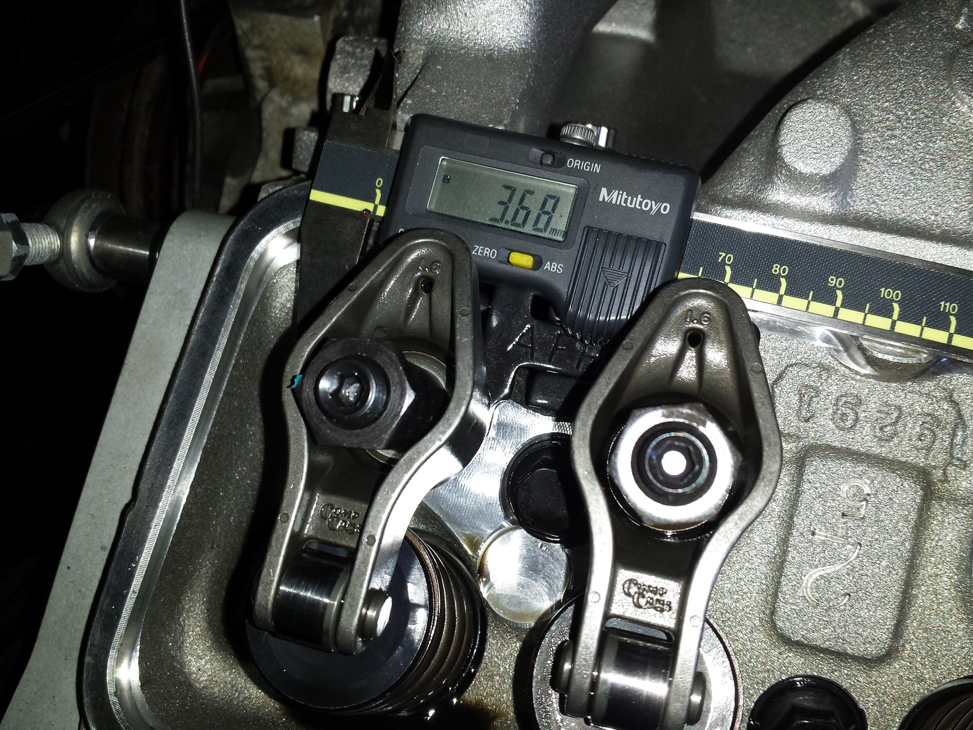

Just as a follow up, I bought Comp Cams 4602
But I don't like to see that the pointed screw was 3.68mm "up" from the nut.
So I took 2 washers, and used them as spacers, they are 3.91mm.
Now the pointed screw is just below the nut, and it looks like it just clears the valve cover.
What do you think??

The locking screw should not stick out above the threads of the outer nut. It's odd that this happened on yours, since (and I double checked) 4602-16 is designed for those rockers. Using polylocks made for full roller rockers will cause the issue you saw. I made that mistake, and the locking screws didn't grab enough threads to lock down tight enough and I had some major problems when they loosened up.

I think it is because the AFR heads comes with "long" ARP studs.
The studs are 0.25" longer "then normal"
Old May 30, 2017 | 01:49 PM
