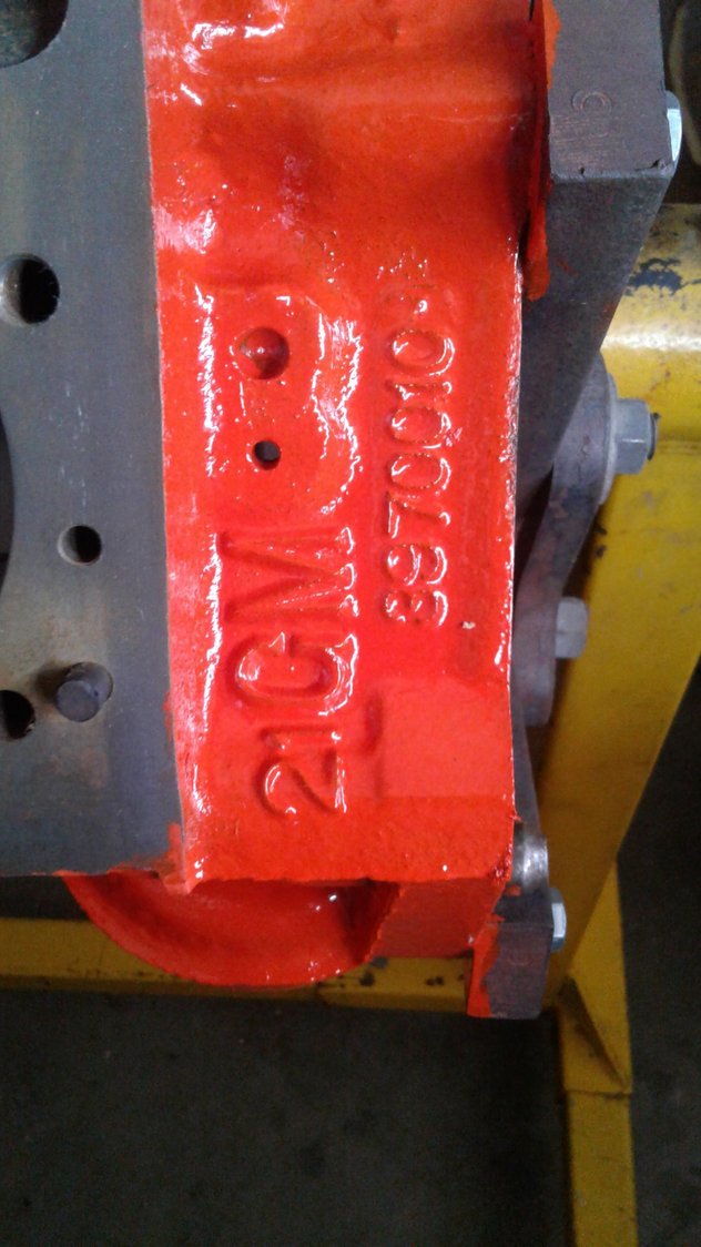

I started to build my 1971 350 today. The fuel pump side freeze plugs were 2 inches in diameter rather than 1 5/8 inches. None of my local auto part stores carry 2 inch freeze plugs. Anyone know where I can get them? Is this normal for a 1971 era 350 block? Thanks

Alan thanks for your response. My block is different. On the fuel pump side the freeze plug holes are 2 inches in diameter. This block is original to the car and is the first time it has been rebuilt. Does anyone know of a source for 2 inch freeze Plugs? I can't locate any locally. All of the kits contain the 1 5/8 inch plugs.

What's the casting date on this block?

It has a March 1971 casting date and is from an Lt1.
