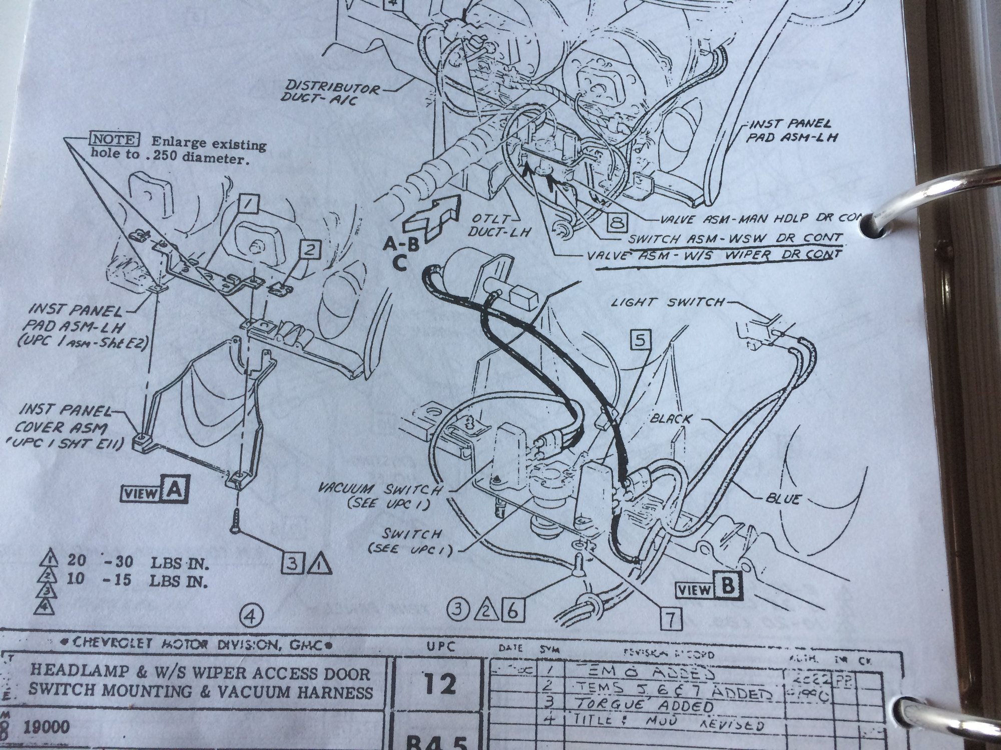

From the 68 AIM

My rule of thumb is the vacuum source hose always goes to the vacuum port closest to the pull ****. Headlight switch and both override switches get the same treatment.
