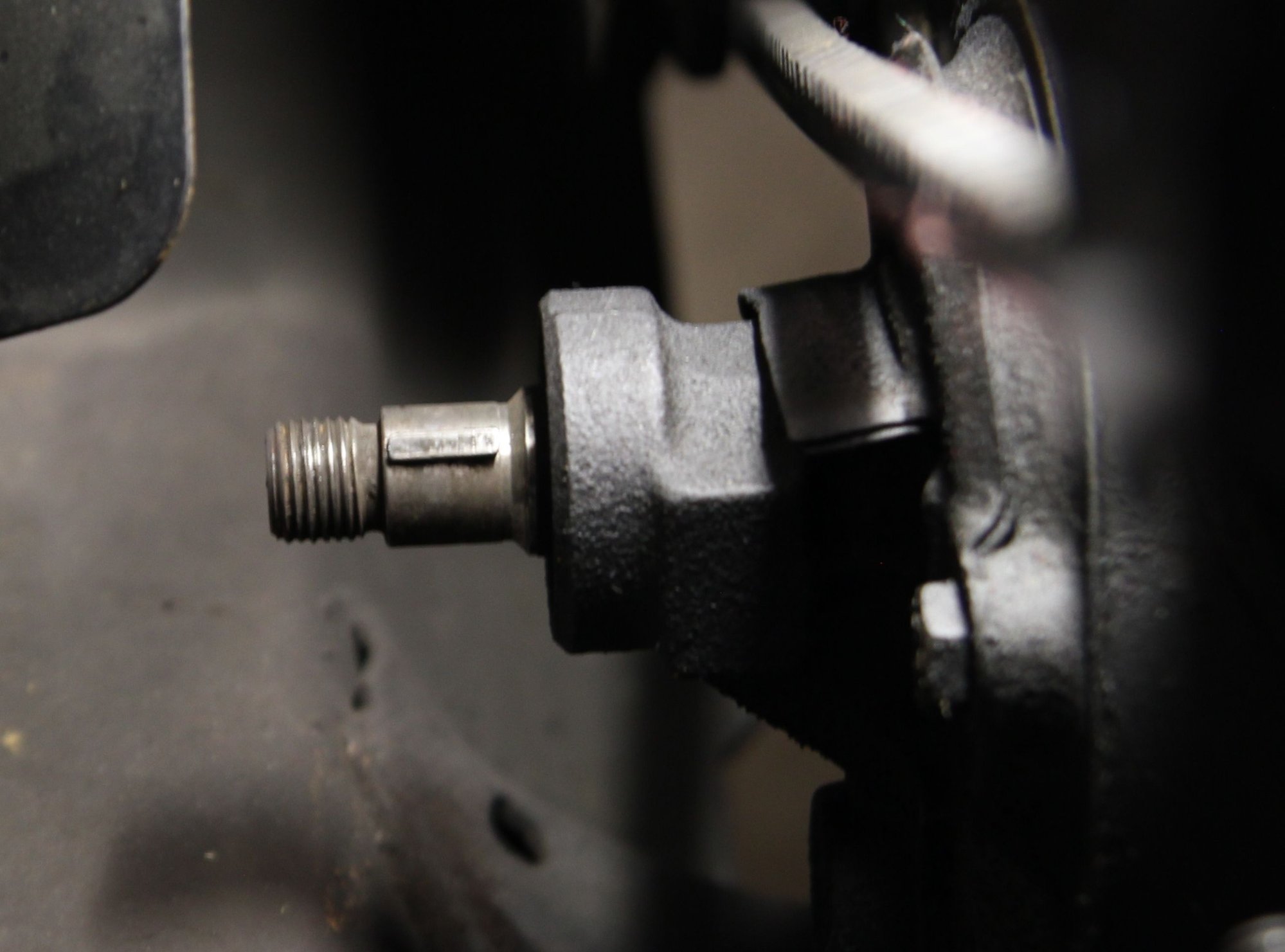

Thanks carrlijc...I was able to get the pulley off tonight. Here are some pictures. Couple things I notice...First, the pulley and shaft do have a key. The cut in the pulley is very clean on one end...then it widens out (but still looks like it was cut that way originally), but then the other end looks like it has been worn quite a bit. I'm guessing this is what caused the slop I showed in my video above.
The number stamped on the pulley is 5106...does that make sense? Is it the correct pulley for this car? My car is a 1970 small block 350/350 without ac. It has some divots drilled into it...when I look at pictures of a new one online, it looks like mine, but does not have the divots?
So - what do you all suggest? If I put it back on, I assume at some point I will lose power steering. Or should I just replace it...and if so, does it look like the pump is still fine? Anything else I should check? The nut on the end of the shaft does not look like the new ones online either...but maybe not a big deal?

Default Hmmm... that keyway slot look worn??
It looks like the keyway slot in the pulley is "worn".....I can't really tell. Has it been loose for quite a while?
It appears that the pump shaft look ok?
Look up pulley 3834720 on that popular bidding site and you can see pictures of the pulley like mine (allegedly will fit yours) and you'll note that the keyway slot is a narrow straight path.....unlike yours with the open slot.

You need a new pulley, the keyway is flogged out from running loose for too long.

If you have a friendly local machine shop take the pulley to them and ask if they can cut a new keyway opposite to the original one and as long as the bore isn't worn from flapping about you'll be good to go.

That keyway is shot.

The old style pumps, like that one, have a tapered shaft and a key that drives the pulley. So I would say to first to tighten up the nut before proceeding to the other options. It should solve the problem

I would ensure that the pulley is "snug" on the shaft before going to get a new keyway cut.... and it if its, then it's probably the quickest and easiest option.
Take the "key" from the shaft with you to the machine shop... so they know what size it is.
I can't believe this idea didn't cross my mind.... good idea. Realize that you can get a good pulley for like 65 bucks on that auction site, but a machine shop might do this really cheap....

It would be nice to cut a new keyway, but keyways are broached. The expense of the array of cutters needed for the variety of sizes, plus the machine itself would lead me to believe it's not a practical option for a machine shop to offer.

Good point about the keyway. Since there are so many pulleys readily available--- I'd probably just get a another one.... with a GM part number on it.

That pulley is junk. Both the keyway and bore are completely worn out. Get an new pulley and hope it fits on the shaft tightly and that the shaft isn't worn out. There should be no wobble once you get the new pulley pushed on the shaft as far as it will go before installing the nut.

Hey all - thanks for all of the input. I agree, the pulley should be replaced. I did call a machine shop (great idea!) and he wasn't super excited about doing the work. I also missed out on the one on that bidding site for $65...but it looks like you can get a new one from one of the on line retailers that supports this site for $105 or so. I think I'm just going to do that. I will keep you posted when I get the part and find the time to put it on. I also thank you for the belt references!
