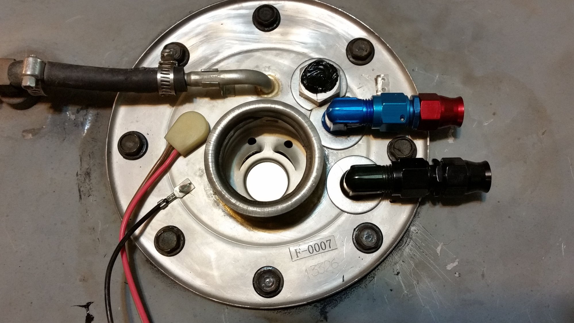

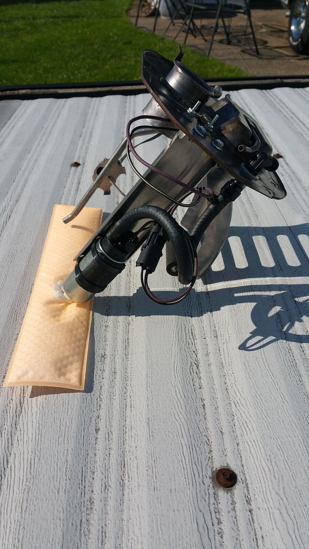

I went with the stainless Rock Valley retro-fit fuel pump module on my '72 when I converted to EFI with the FAST Ez-Efi system. This is a pic of my finished tank:
Some more pics of my tank build are in this thread, starting at post #5:
https://www.corvetteforum.com/forums...fuel-tank.html
