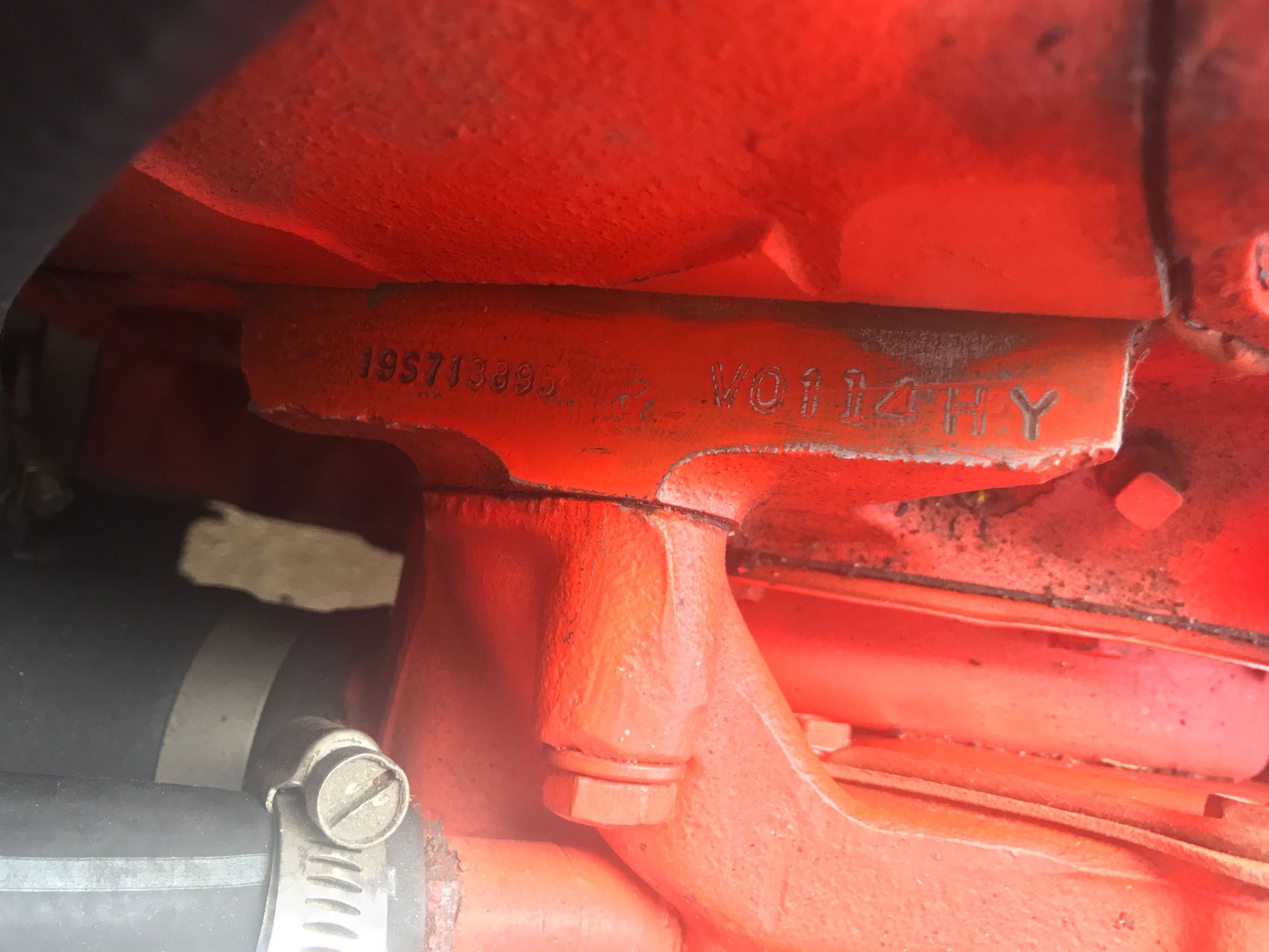

im trying to establish if my 1969 corvette convertible has a matching numbers motor.
Attached is the picture of the serial number on the motor and my VIN.
VIN: 194679S713695
motor: 19S713895 or could be 19S713695 (see motor picture)

Looks like a very clear 8 to me.

Based solely on the numbers, both of which are very clear to read, the answer would be no.
It is very interesting and curious though that those numbers are off by exactly 200. Therein lies the mystery....

I agree. That's an 8.

I think it would be a good idea to remove the paint from the pad at this point, (There wasn't any on the pad when the pad was stamped at the Flint engine plant and at St.Louis.)
This will help you to see the surface of the pad.
DO NOT use ANYTHING abrasive to remove the paint. Use something like lacquer thinner or citrus paint stripper.
Seeing the pad surface MAY give a clue as to what's going on with the VIN derivative stamp.

thats the strangest thing. If the motor was replaced, how was a motor exactly 200 apart located. As in, huge coincidence, or not?

Or restamper who didn't pay close attention.

Your car(VIN 13695) was built in Feb. 69 and the engine (V0114HY) was built Jan. 14, 1969 (We would need to see the casting date to confirm 1969). HY indicates a 1969, 350/300, 4v, m/t 4 spd.
What does the stamp on the transmission show? The engine and transmission were stamped at the same time, using the same gang stamp.
As Alan71 explained, just use a soft cloth and some lacquer thinner to remove the paint from the pad.
