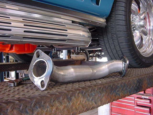

Check this out.

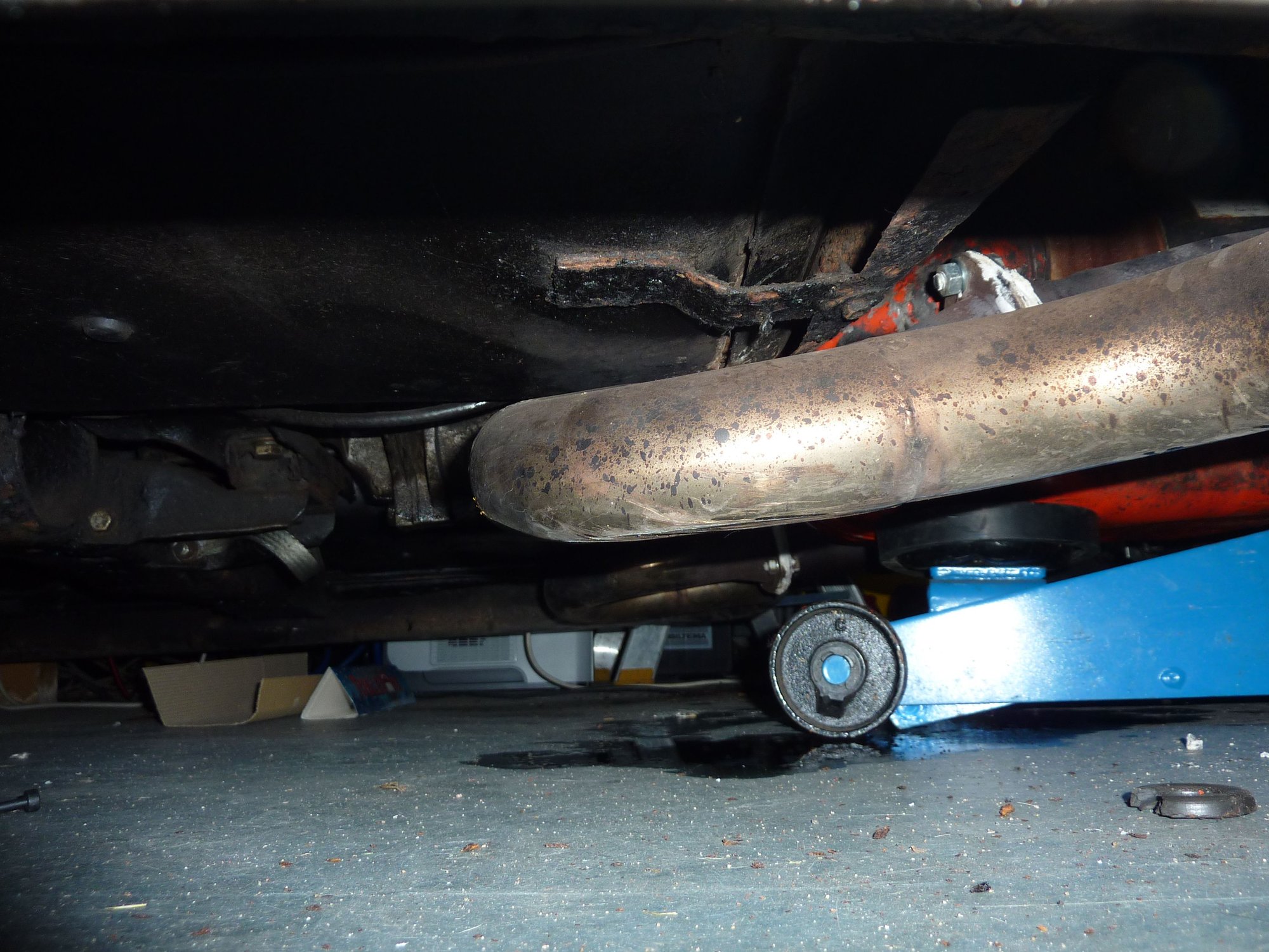

[QUOTE=Kid Vette;1595077994]Check this out.
Looks nice but I decided to go with the original layout but it will involve a lot of money so for the moment I leave it as it is. It needs new headers new exhaust & hangers and someone throw away the rockers under the doors so I need to get all these first. And also the way they have put in the pipes the groundclearance is very bad. As you can see they connect the pipes to the headers with a 3" tube in S shape.

AND it's likely 'hotter than he11" in the cockpit, due to those big pipes running under the floorboard without any insulator between!
If you have room, your best option [at present] would be to put some resonators in the down-tubes from your headers.
