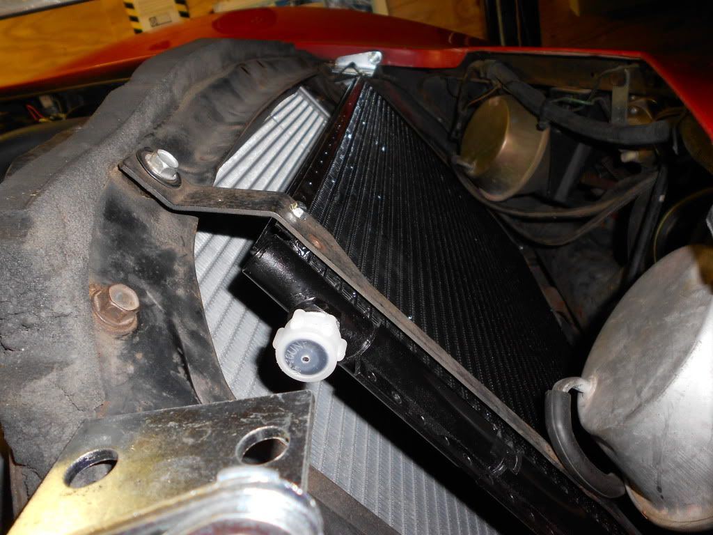

I'm using a parallel flow condenser. Also using a Sanden compressor and adjusted the POA for r134a. AC is very cold and high side pressures dropped quite a bit with the new condenser.
My condenser is a universal one. I welded mounting tabs to it so I could bolt it to the core support. Used the little rubber grommet things you use to mount a wiper motor. Line adapters were braced on by a local AC shop.

A local shop custom made the hoses. For the POA valve, mine is an old replacement from NAPA. I'm not sure factory POA is adjustable, but my replacement is. To adjust I have to remove the upper fitting to access a tiny screw. I turned it counter-clockwise 1/4 turn (per recommendation from the internet).

Here is the one I installed. I got the biggest one i could squish in. Fabricated my own mounting tabs.
It is a CNFP1624 AC A/C Universal Condenser Parallel Flow 16" x 24" with O-ring #6 & #8 connections.
Below is a pic ... you can read the thread for more info....including a comparison to the condenser that came with my hot rod a/c system and other pictures.
