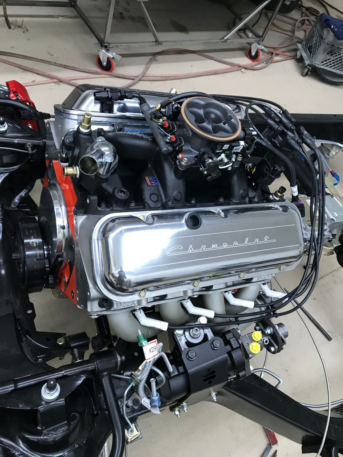

Set of Headman headers tucked in nicely in my '73 frame. This is with a borgeson steering box as well
