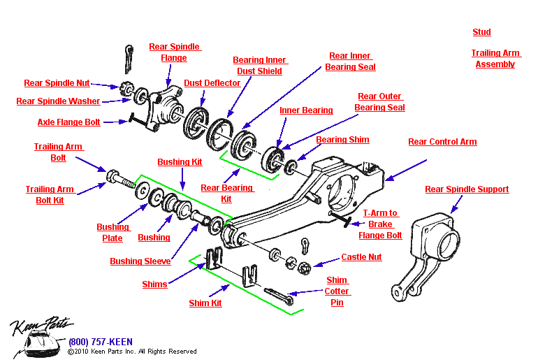

You might also check to see if your shims are still in place. If they are missing or the bushing is loose on the bolt the outcome can easily fit the description of what you have experienced.
Check out the Trailing Arm Bushing Kit in the image below. This is what you are looking for to see if there is any lateral movement about the Trailing Arm Bolt.
