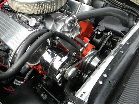

Here's a shot of mine so you can see the hose connections.
Has electric fans and non corvette specific brackets and pulleys.
