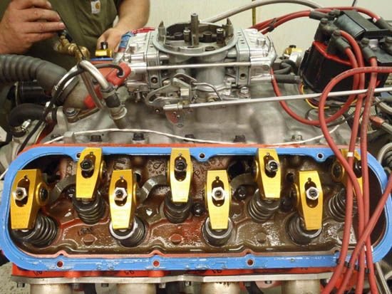

aftermarket regular height, with crane roller rockers, had to very slightly clearance a couple of them.
Those look like the rockers that I have as well. I bought some aftermarket "original" valve covers and no luck... They don't have enough clearance. How did you make them fit?

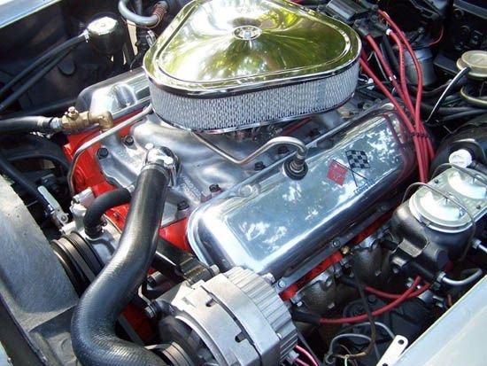

Here is mine-- no slant on the left cover, clears the brake booster too.
(sorry I don't have a better picture of the left side)

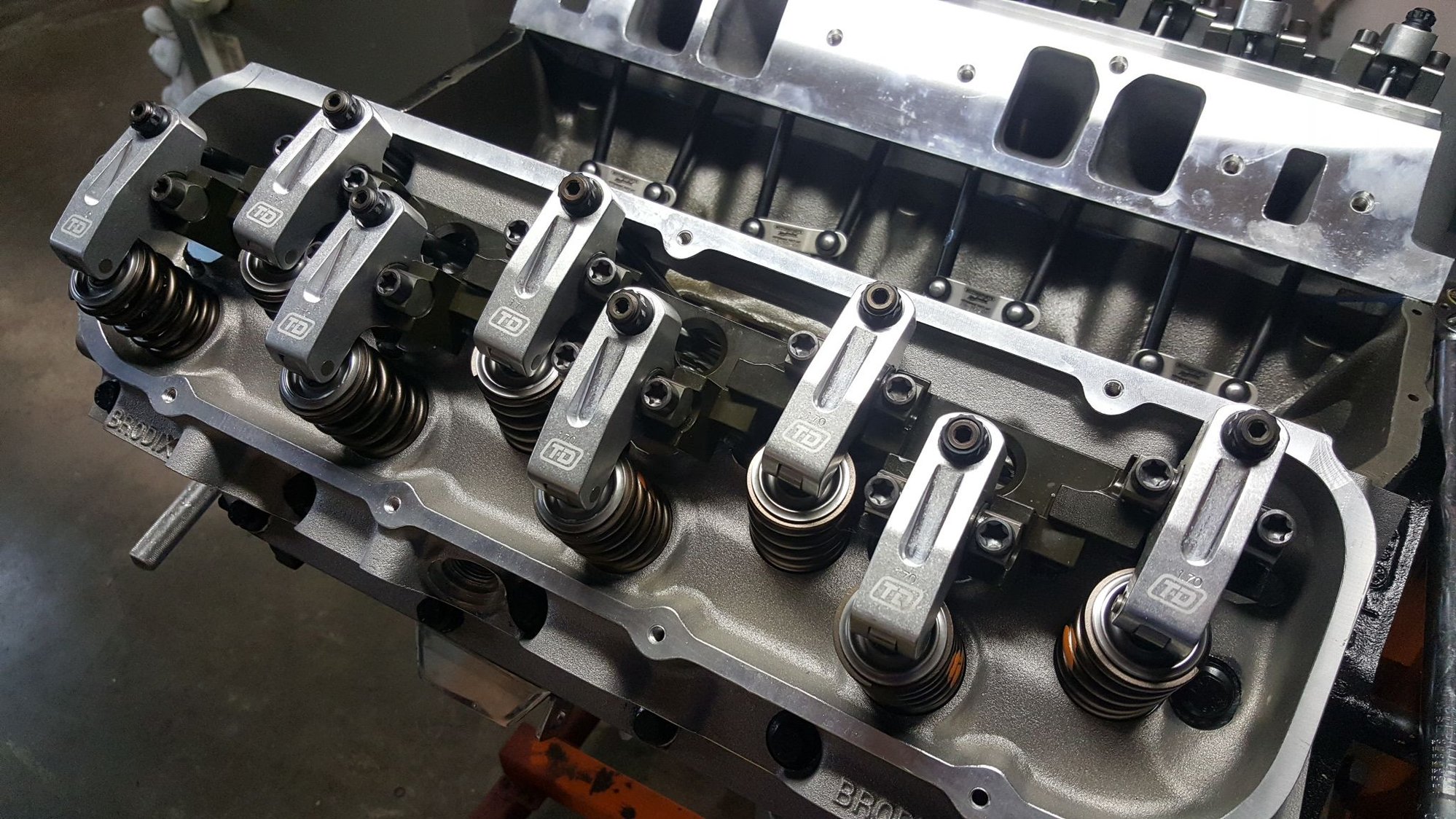

You could solve your problem w/ some spacers-
Any problems with the rocker end tapping up against the valve cover PCV baffle or the vent baffle on the right side?
Honestly, I was concerned about that too. I set both covers on with loose bolts to hold them in place without gaskets and turned the engine over several rotations. Covers never moved. Since then, I've had it running. When I pulled the covers and valve train to re-torque the head bolts I looked for any signs of rubbing. Nothing at all. I had one pushrod that had a shiny spot from an intake bolt. Replaced that pushrod and ground about 1/2 thread off that bolt.
