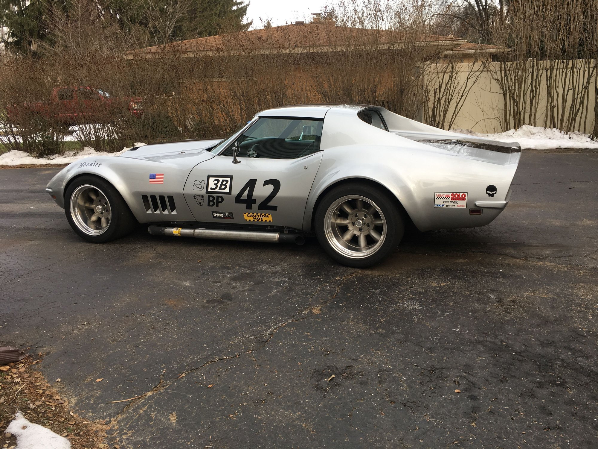

I have Stahl headers by ACP. 1-3/4" primaries, 3" outlet, no ground clearance issues except maybe over large speed bumps which I don't often encounter.
Here are a few pics with the longer mufflers installed before they were painted.

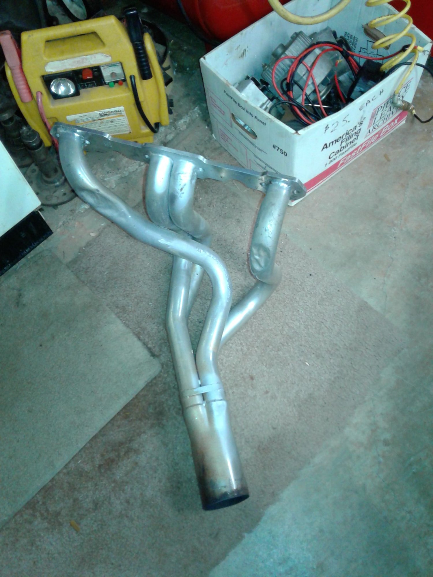

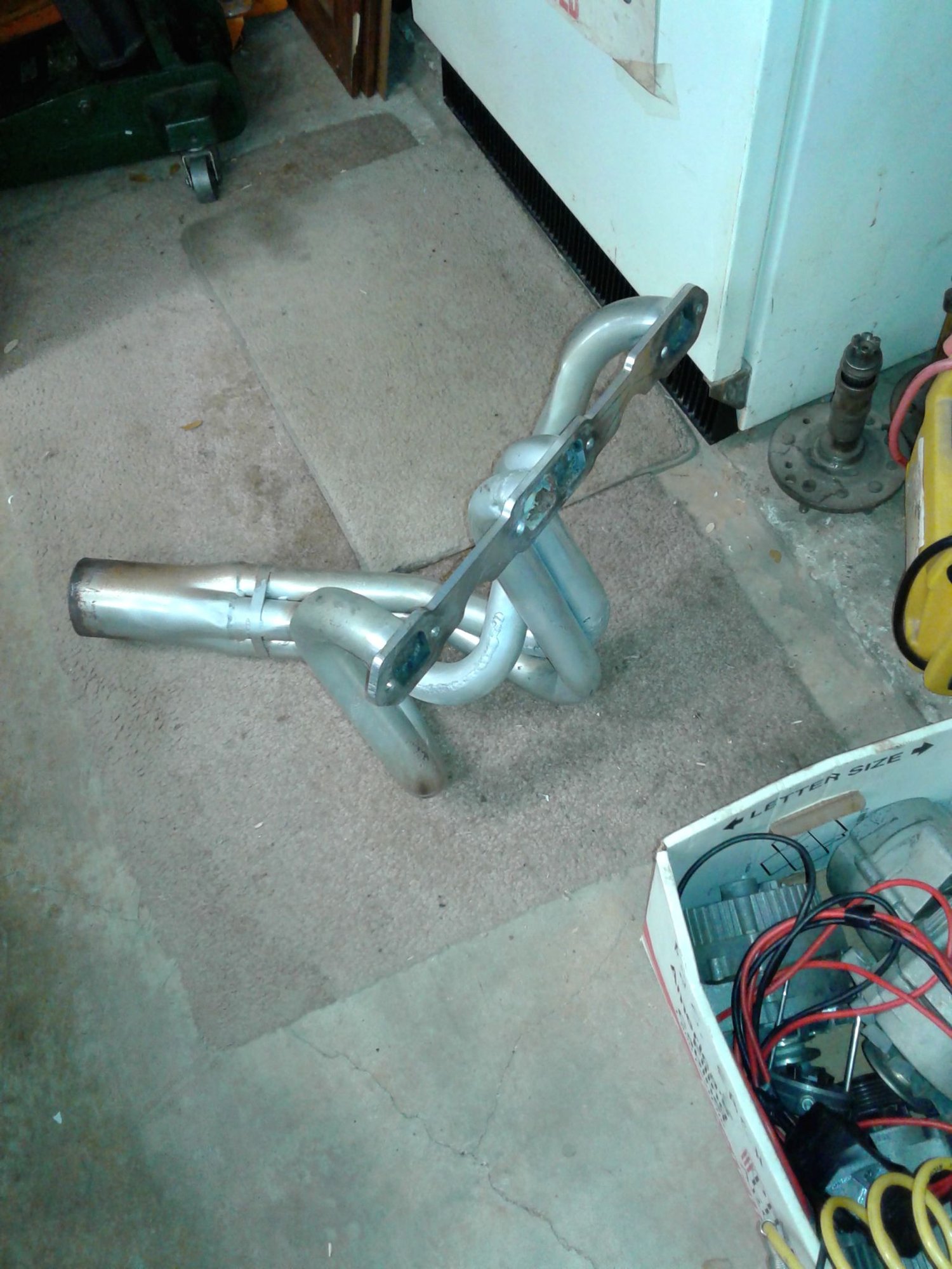

I ran Stahl's years ago. No issues at all, but I went back to factory sidepipes. If you decide on Stahl's, contact Kerry at ACP Composites. I do not know if they fit cars with air conditioning or not. The Stahl's make more power than the Hooker and Kustom style side exits, so I was told by Jere Stahl. Also somebody by the name of drl88 used to sell side exits that look like what the Sunray/ DX cars used. The last set of drl88's headers I saw were priced at $4800 including tailpipes. No, not a misprint, $4800. I think Kevin MacKay at Corvette restorers sells them, or at least a period correct version. Here is a picture of them
awesome vette!!
This is definitely the look I'm hoping to do with my C3. Awesome!
