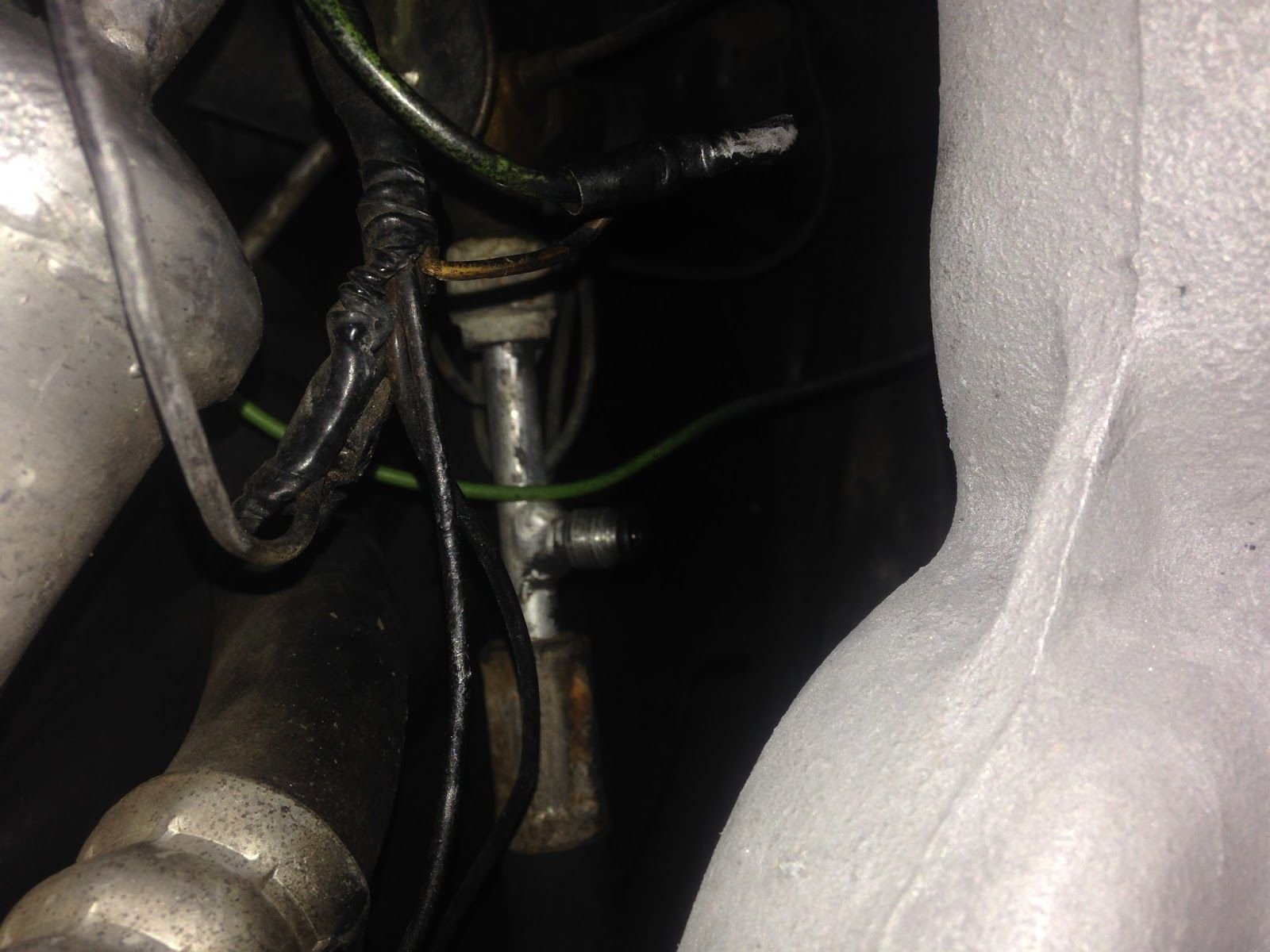

I found another fitting on the hose close the the exhaust manifold....I'm not sure there would even be enough room for a fitting on this one....It would have to be a 90 deg. elbow. This fitting is the same size as all the others.
Brian

The local parts stores usually have an assortment pack that covers whatever you need. They are on ebay also. Easy way to tell the size is a 7/16 fine thread nut will thread on the 7/16 fitting and 3/8 fine on the smaller one. I have some but it would cost more to ship them than to get them locally. The 7/16 low side adapter also comes in a 90*, I have seen them at Napa and advance.

I think all the fittings are 7/16" and the kit above should work just fine....I can over complicate the simplest things sometime.
