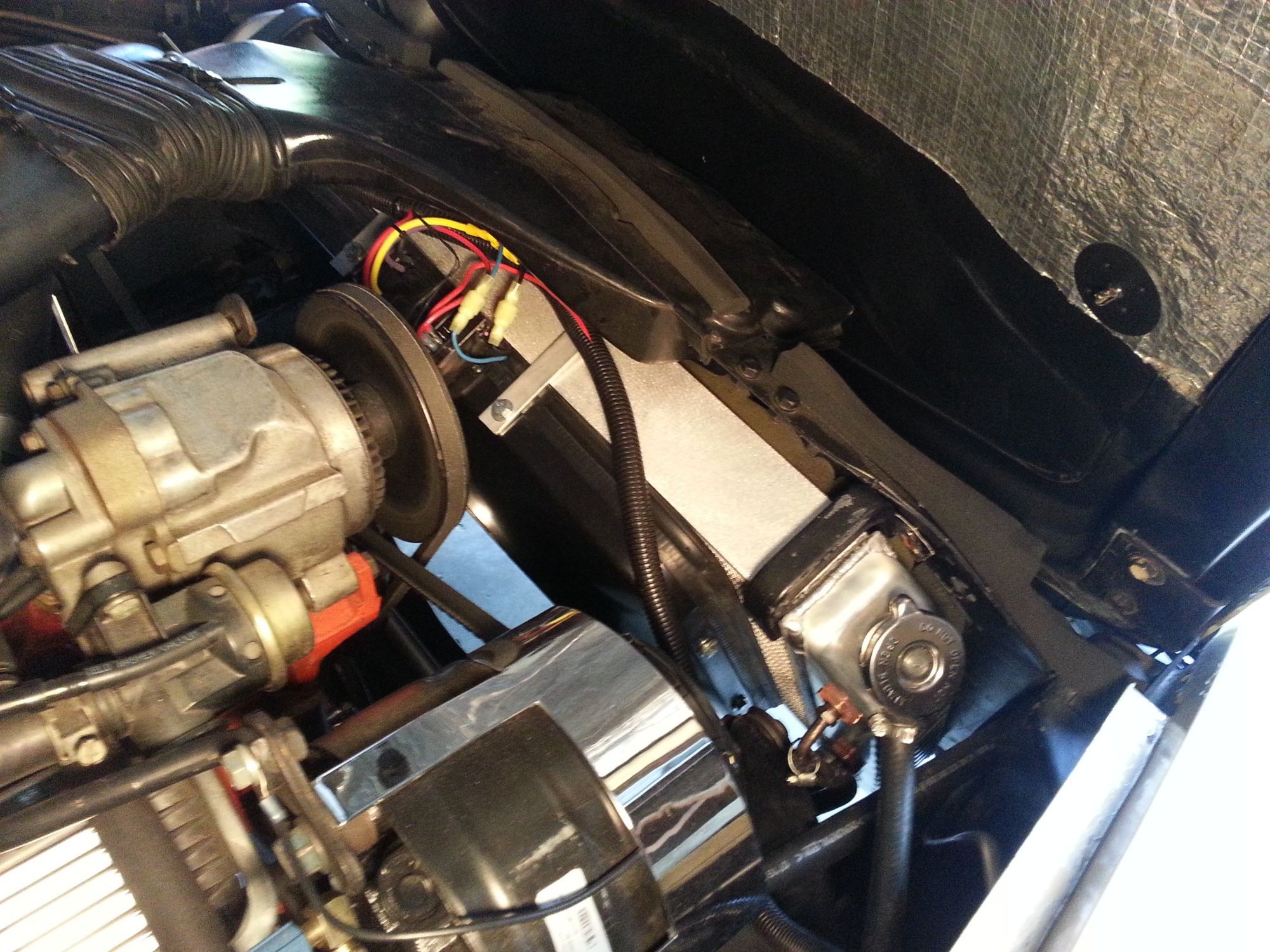

Kevin - I am using a Flex-a-lite black magic... https://www.flex-a-lite.com/15-inch-...ontroller.html
The top to bottom coverage of the shroud is good although the side to side coverage leaves perhaps three inches on each side outside the shroud. That said the shroud fits in &between bolts for the A-arms and in front of the pullys so there is no installation hassles.
Being in LA and having the air conditioning on and willing to drive in traffic on hot days - the big-ish 383 can overtax the radiator and fan. Turn off the AC in these worst case conditions and the fan pulls the temp back down to thermostat temperature relatively quickly. Hit the highway and temps come down quickly.
Be aware that these high power fans need a fair amount of amps - so cabling has to be taken into consideration on the install.
I have a beautiful DeWitt radiator also.
Happy? Yes. Modern car perfect... no. That is not to denigrate either the radiator or the fan - its asking a lot to cool these beasts at the boarder line under difficult conditions.
All that said - I kept my stock shroud from 15-years ago when I started using electric fans in the event I wanted to switch back to an engine driven fan - but I'm not ready to do that.
Slightly off topic, but that accessory with the belt around it on top, is that part of the smog system? I'm in the early stages of planning to rip out the computer and smog system in my 1981 and also have that accessory. It seems to connect to those damn pipes on the exhaust manifold making me think its part of the system that I can remove.

That is the smog pump.
