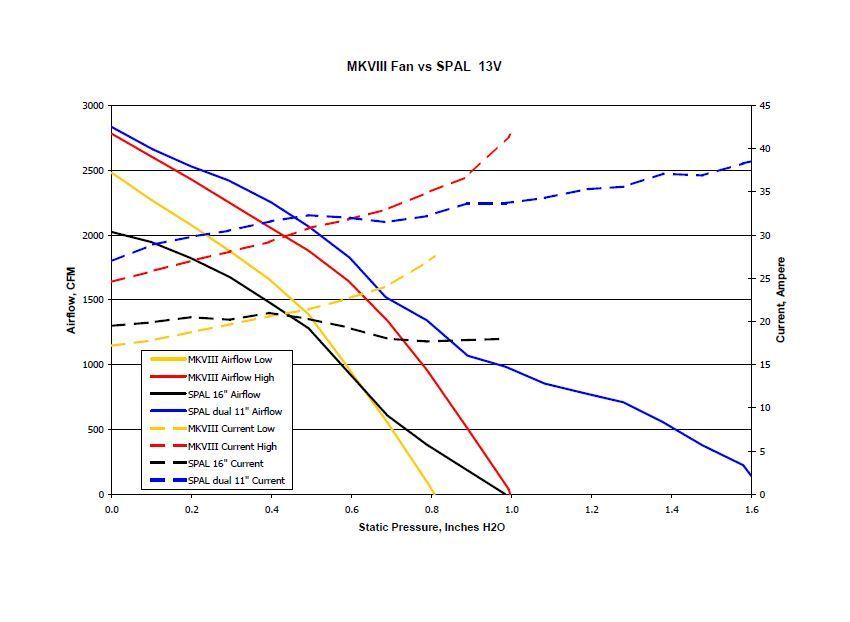

And here's a CFM chart from DeWitts..unknown as to whether he tested the 1850 rpm speed or the 2225 rpm speed Mark VIII.
https://www.corvetteforum.com/forums...pal-duals.html

I have a 1998 Mark VIII fan, part numbers RF-64 and/or F8LH-8C607-AA, only has leads connected to the 2 outermost male terminals. I bought it new. It is cooling a Ram Jet 350.
It apparently is a single speed fan that would normally be varied by the lincoln powertrain controls.
I had a PWM on it for a while before I installed the EZ-EFI 2.0. I am now controlling it with the EZ-EFI 2.0.
I have it installed on a Summit Radiator. The shroud is not trimmed. The fan "legs" were removed and I made my own brackets to mount the radiator and made my own brackets to mount the fan.
The fan fit snugly in front of the sway bar. I was going to trim it but it was minimal interference so I just let it be. There is no issue with the spreader bar. It has been there for 10 years.
Are you controlling the fan as either on/off or variable speed using the Fast?
