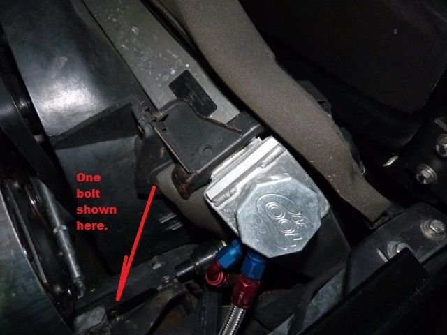

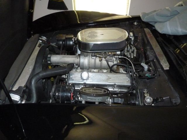

I'm running a spreader bar with stock shroud, blower belt. I used a Speed Direct spreader and drilled and tapped the upper A arm supports so I could place it where I needed it.
See below.

Please post me a pic of your full engine compartment,

Won't win any awards but here ya go. Let me know if you're interested in something in particular.
Here's a good shot of the spreader bar bolt in.
