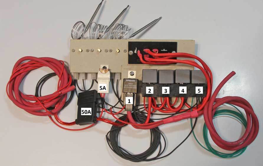

Since these mark fans,( likely biased, poorly detailed testing aside ) put out at least 3000 cfm to cool the way they do and likely closer to 3800 cfm and reports of their amp draw got me thinking of controllers,
I then putzed around in internetland and found a cat who being sick of electronic controllers that failed him made a multi step relay controller,
it bit large and cantankerous for me but I love it when people make something like this,
In my case I do not like the all or nothing fan switching, these fans do spike when they come on but if the system is up to par its not a problem but even with my Taurus fan it stayed mostly on lo and hi when it did kick on was pretty loud, and if I didn't need hi I did want to run it so I liked the simply relay set up for my 2 speed Taurus,
I was going to use dual 12 derales, use relays to run them both low in series or both high in parallel but the gears in my head grind ADD OCD and now I want that big old mark viii and a couple years of them are the big mac daddies, I guess I have to hit a u pull it bone yard,
but one speed, I cant do that, too OCD,
Nor do I want that cool stepped set up relay controller that other cat made,
