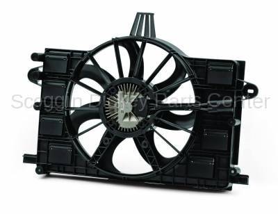

No numbers, im just doing some preliminary research typed c7 corvette fan in ebay,
I didnt get the c7 shroud measurements so looked up 2016 core measurements if correct it was okay but not as good as the 94 t bird mk8 shroud that fits the c3 core almost like it was made for it,
I have no doubts c7 designers know more than me but note what seems to be a hanger on top of the fan where the top of it is out off the basic shroud,
I believe this c7 fan would get my OCD all worked up from its odd fit, and likely wasting some c3 core,
The c7 shroud also has lots of trap doors meaning designers knew or feared air flow at speed with fan off is poor, the bird mk8 shroud appears more free flowing at speeds,
Opinions vary but to me no good reason to run a fan when vehical is at speeds sufficient for air flow cooling.
This for me is all about bang for the buck and kiss it,
i really like the idea of two speeds, the bird fan has that, i can use the bmw dual switch and a couple relays, low on at 195 and then high on at 205, cheap controller,
cant do that with the single wire c7 fan, it will need to be wired full on full off, which i dont want or on an electronic controller like factory, not cheap.
My guess with bird mk8 fan i wont see high speed much and why run on high if not needed, i am curious what percent low is compaired to high 100%
So im back to placing the bird mk8 fan top on my list, if i shop around i can find it about 75.00 new, to me new is more peace of mind than 20 some odd year old used...ocd is a bitch.

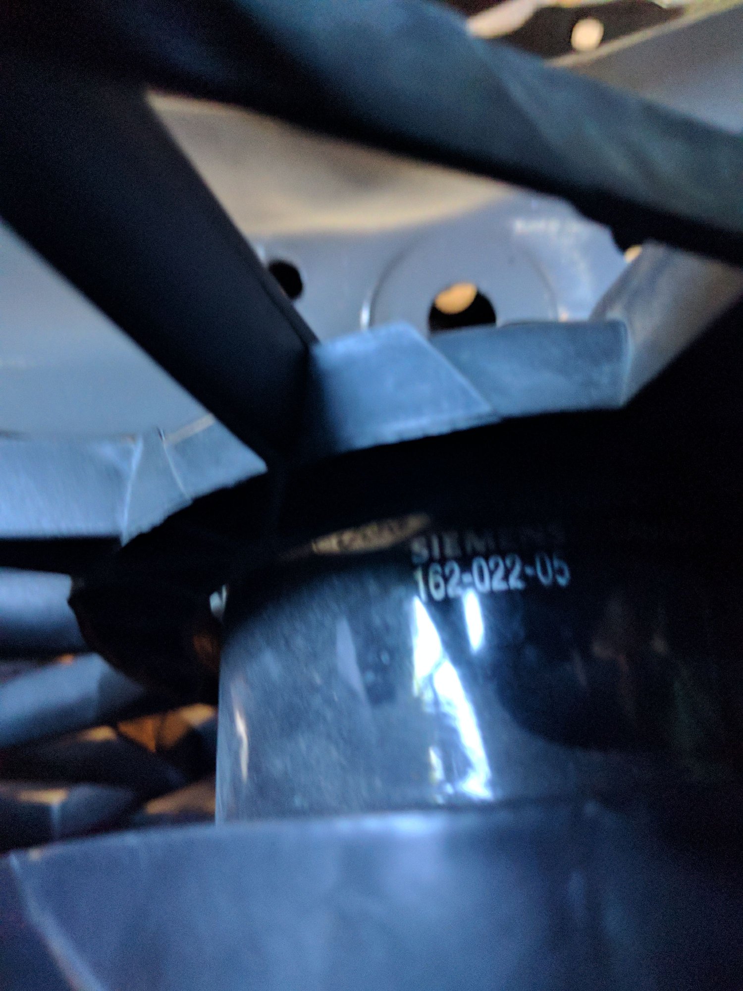

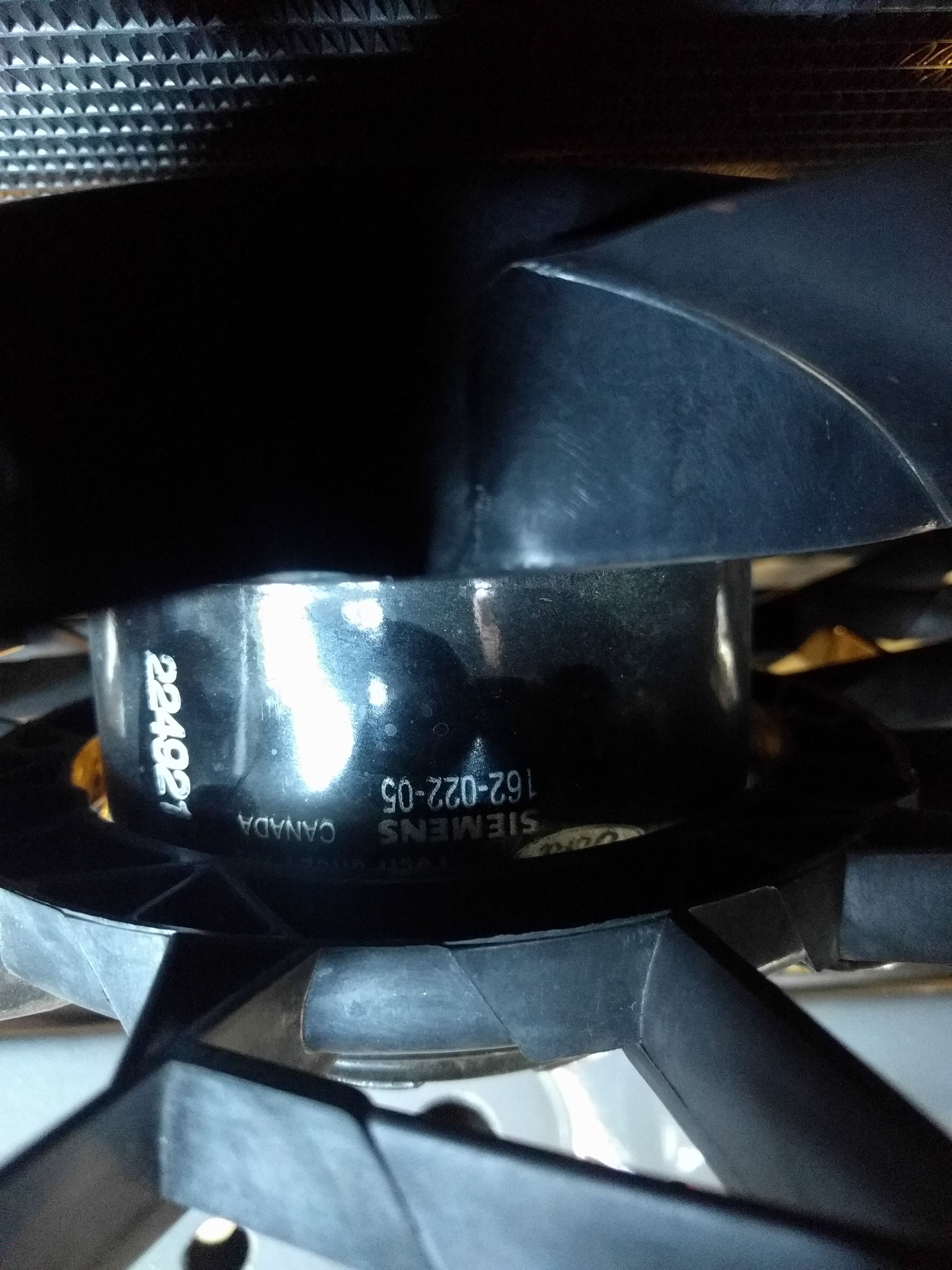

Finally got around to getting the Siemens number off my Lincoln Mark VIII fan MOTOR. Now, if someone is a Siemens deciphering Guru, then perhaps we can find this fan motor:
Siemens 162-022-05.
