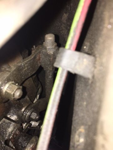

It looks like mine is set for short throw, is that correct?

Hi HB,
I believe you'll find that the reverse lever typically has only one position for the rod's clevis connection.
That's why I suggested looking for a worn clevis or thinking about shimming the shifter bracket.

Thanks everyone. Alan is likely right about a worn part. The shifter hits on the front of the console. It does not affect getting the transmission into reverse but seems like it has a lot of slop in the travel. The other gears seem fine. Also, I definitely do not have the short throw setup. Just got back from a nice ride up the Mohawk Trail in Western Mass and was more conscious of the shifting. The travel is quite long. A shorter throw sound like it may be fun. We have only had the corvette for a little less than a year so still in a steep learning curve. Thanks again for your insight.
