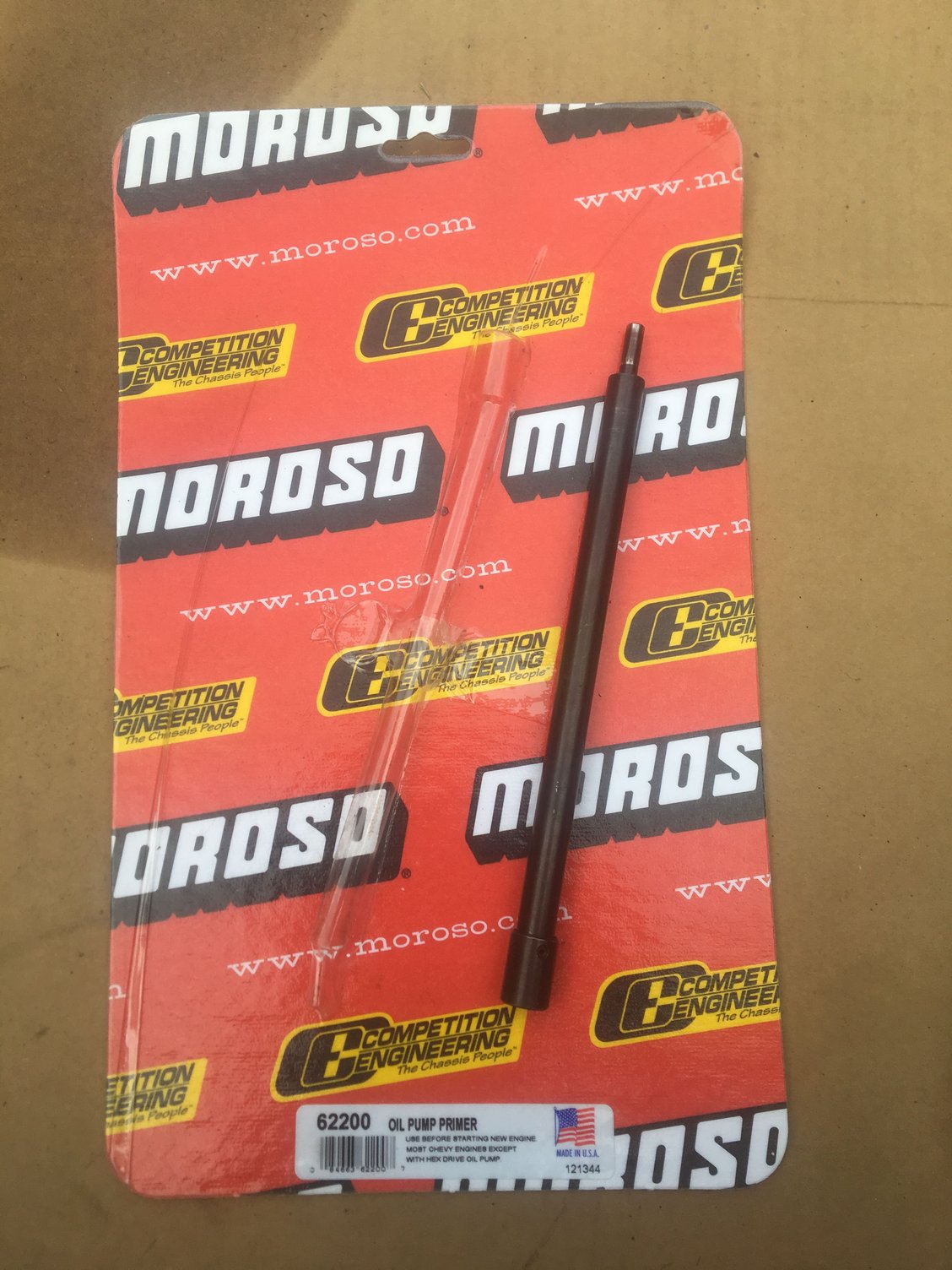

This is the tool that im using now
Also The oil sendin unit is already hooked up.....
so i should use my distibutor housing with this tool ?
how would i go about doing that ? Taking the distributor apart ?

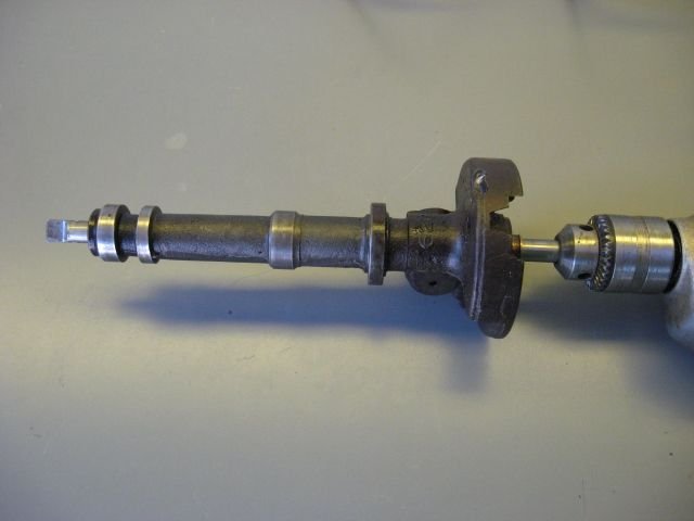

One like this will work. It will seal the passages. I've also got one where I just ground all the teeth off the gear of an old distributor, cut off the top and attached a drill to it.

That tool does not block the camshaft. All you are doing is priming the crank with it. You need a tool with the aluminum block-off on it to also prime the top end. see linked autozone pic above for the type to get, but don't buy that one as it is machined wrong. I can't remember where I got mine as it was decades ago, might have been Jegs.

That tool cannot be used by itself without having a blank distributor housing to seal off the oil passages. You are just dumping all the oil right out of the pump and right back into the oil pan. If you want to pressurized and prime the oil system all the way up to the top of the heads, you must use a distributor housing or a complete priming tool to do it right. Here is my "priming distributor" with the priming shaft hooked up to the drill motor. The tool you use needs to look like this:
Just grab a junk Chevy distributor out of your parts shed and strip it down to make the tool.

Without a distributor body installed in the block, you're just dumping oil right out of the main oil galley right back into the bottom of the block.

There is no way you can get oil pressure up to the top of a Chevy engine without sealing off the oil passages using either the tool shown by 427Hotrod or by using a distributor housing. The distributor completes the oil passage - it's the reason the distributor has the grooves and lands on it - to create the oil passage. You can get oil to the crankshaft, but that's as far as it's going to go without the blockoff tool or a distributor housing.

Junk distributors are usually free... and they work perfectly as priming tools.

Either of the oil pump tools should get you oil thru the filter the better tool will give the top end .

Correct - any tool (or lack thereof) will get oil to the filter and to the crank (at a lowered pressure), but the passages have to be completed in order to get oil up to the top of the engine at full pressure.

You can walk up to any junkyard or larger engine rebuilder and say, "Hey, buddy, you got a junk Chevy distributor I can have?" They then point you to a 55-gallon barrel full of junk distributors and tell you to help yourself. Free tools are cool (actually, I think I gave a guy $5 for one the last time I needed one in a hurry after having loaned out my sweet junk tool shown in the photo above).
