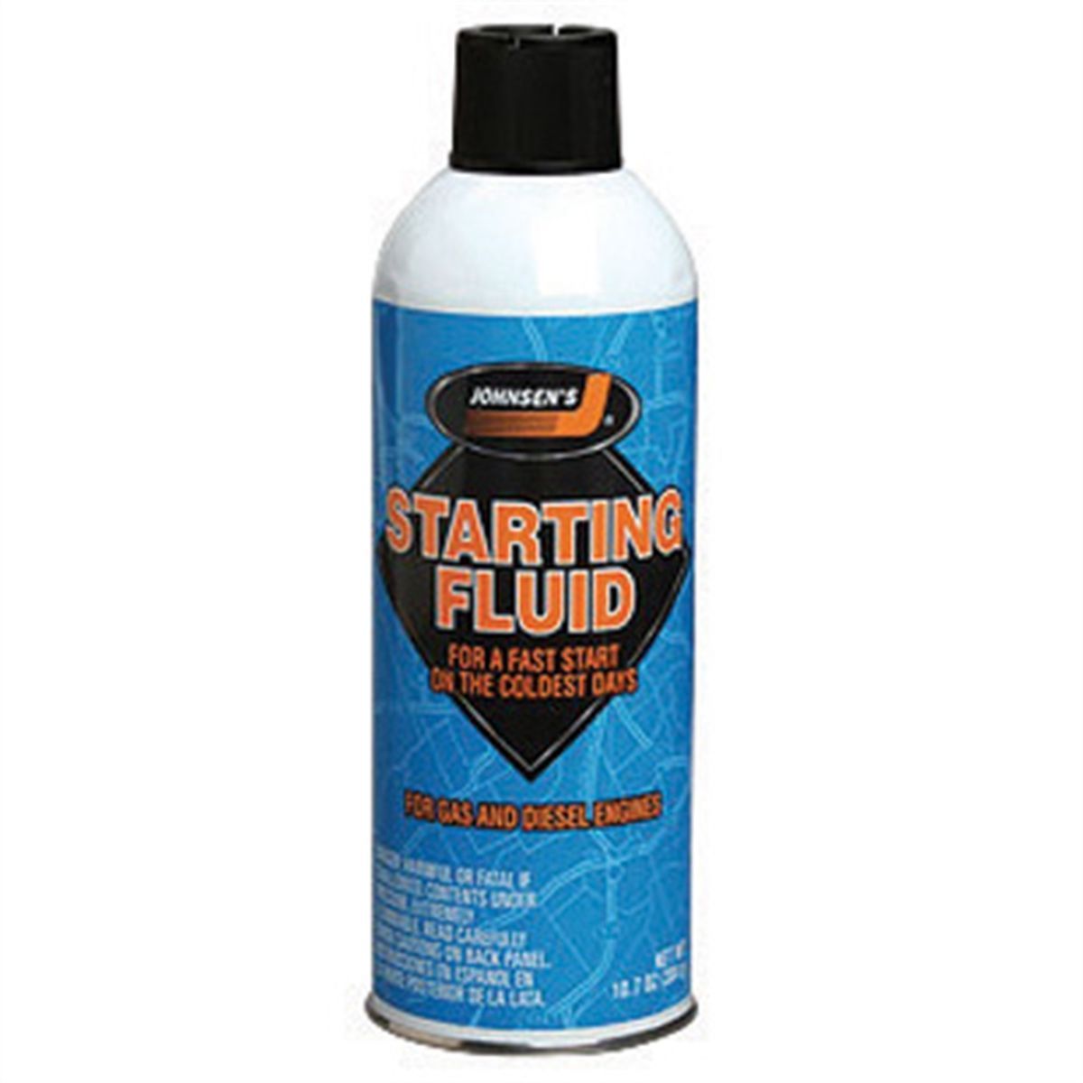

Originally Posted by 7t9l82
To avoid excessive cranking if the car sits several weeks and the gas flows back into the tank or somehow evaporates I keep a small squirter bottle of gas and squeeze some down the bowl vents give the pedal 2 pumps and mine starts so quick you don't hear the starter. By the way those mini starters are great.
I pretty much do the same thing, but rather than using a squirter bottle of gas, I use this:
