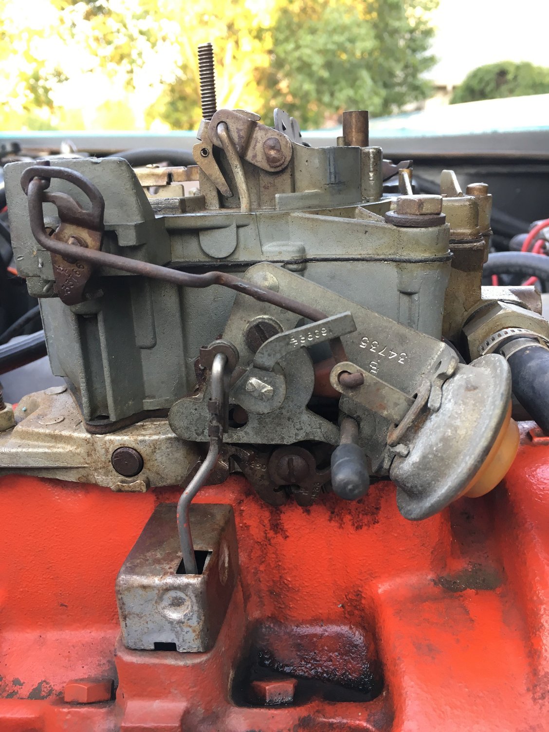

Originally Posted by Revi
The choke isn't opening up as it should. Post some pics, so we can see what is going on.

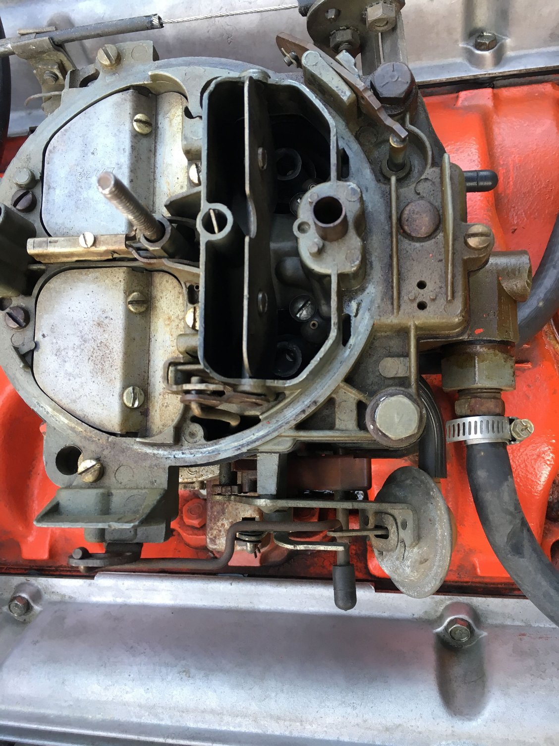

Your first picture shows the choke fully open, this is how it is supposed to look when your engine is at operating temperature and your idle should be 750rpm.
When you start the car, pushing the gas pedal to the floor will set the choke (fully closed), once you actually start the car the choke should open up about a 1/4" or so. (That's what the vacuum pull-off does.)
If you touch nothing else, what does your car idle at cold?
The "fast idle cam screw" that mardyn talks about is what is used to adjust idle speed when the engine is cold and with the choke open 1/4". (I have mine set to idle at 1500rpm.)
As the car heats up the choke thermostat (the little coil spring under the metal box on the intake manifold) heats up and starts moving the choke to the fully open position and reducing your idle speed at the same time.
Some times the choke thermostats go bad/need changed or perhaps your choke is sticking closed a bit?
FYI - you shouldn't have a rubber fuel line running from the fuel pump/filter to the carburetor. It also looks like you are not using any vacuum advance going to the distributor.

The car at cold actually idles low, around 500 and need to rev it to get it going. Once warms up the idle increases and then while driving and coming to a light the idles is up around 1700 and then I can rev it to kick it down to 750 range.
Great catch on the fuel line. I did not realize this as I recently purchase this project car. I will make that update to steel lines. As far a s vacuum I have a Mallory Unilit distributor and it does not have vac advance.

You probably have several issues going on: The carb is one of the dreaded "commercially rebuilt" carbs, and it has been pieced together with several mismatched components. The airhorn and the throttle plate are Pontiac parts, and only the float bowl is Chevy. If the builder did this to the carb, they also did not pay attention to proper operation and function of the choke system nor to fit and operation of the throttle plates to the throttle bores and shaft bushing slop. It would not be possible to find all the problems on that carb without an actual teardown and inspection - I'll bet you would find several odd and incorrect items that are contributing to the fast idle issue and other problems. I'd suggest you find a good, correct, rebuildable core and start from scratch.
