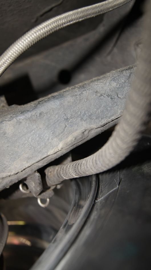

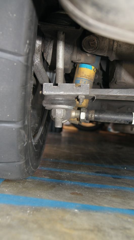

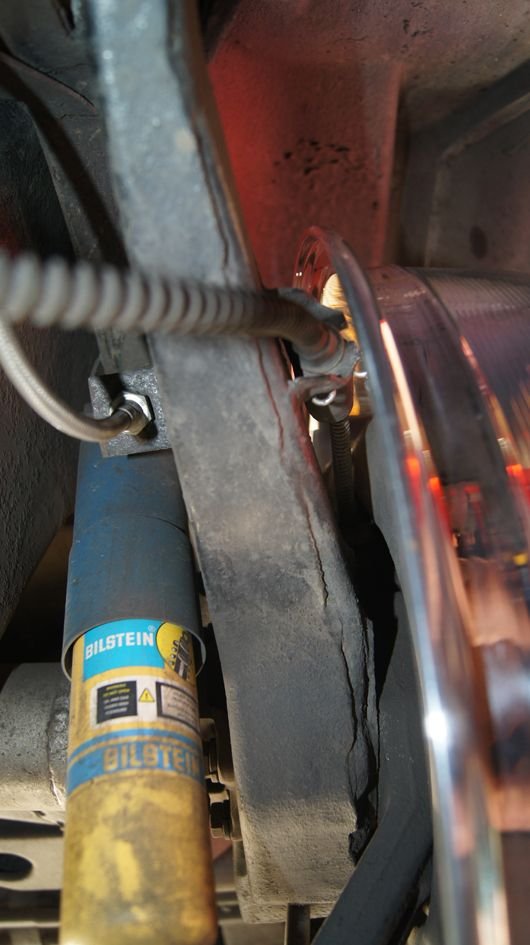

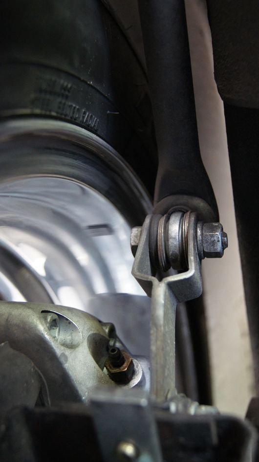

1978 C3. I have the VB&P Rear Sway bar with OEM TA Rear Sway mounting. VB&P Street and slalom rear kit. No mods from factory other wise. The front is a little different. Due to poor pace car spoiler fitment I cannot get full steering lock due to the tire rubbing the spoler after 1 full turn of the wheel.
I looked at 285 and I don't feel they would work. Allowing for tire flex in HARD cornering may rub. The 275 is the widest I trust at this time. My first track day with the 275 is at the end of the month so I will be able to provide a complete assessment of 4.75" bs. But for street use I don't see any problems on my car at this time.
Here is my Rear sway bar connection.
Here is the clearance of the e-brake from the rim. Before I mounted the tire.
Sway Bar Clearance with tire mounted.
Spring Clearance.
E-Brake Clearance.
