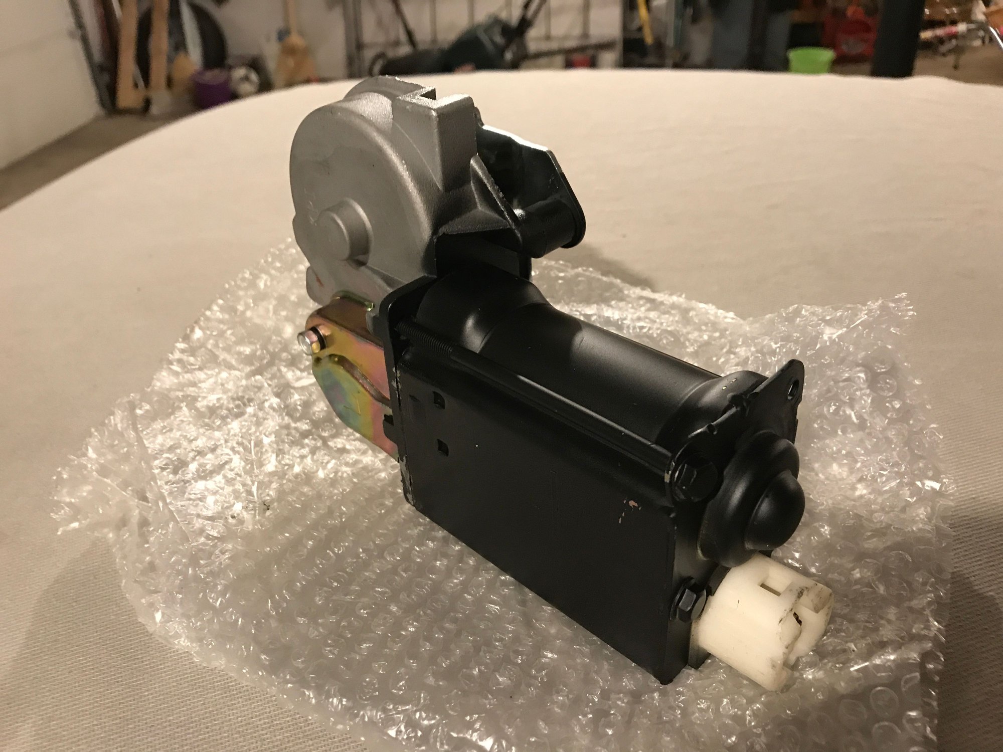

I've been busy and haven't had much time to work on the C3 but I finally got around to putting in the replacement motor last night. Process was straight forward and thanks for all of the guidance from the folks here.

Glad that you came back and let us know that it is repaired and working to your liking.
