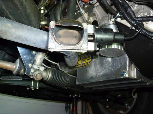

Growing up with hot rods I found the C6 to be a little tame in the sound department. I have NPP exhaust but sometimes want louder!
Now have 3 options:
1) Quiet
2) Respectable rumble
3) Wake the neighborhood!

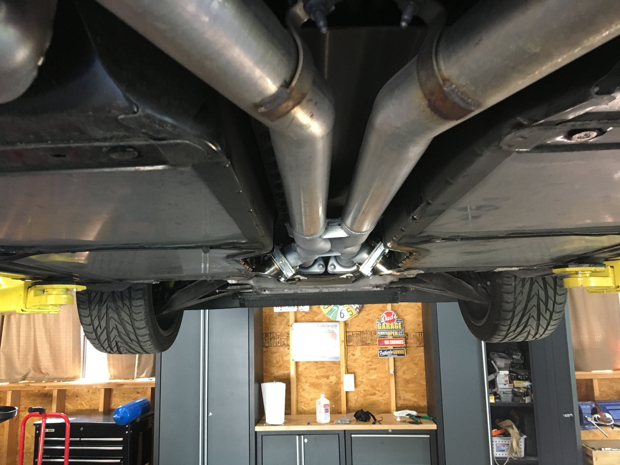

Not a lot of room in a C6 for cut outs. Most position near the trans and leaf spring. However, with an automatic there is even less room than with a stick. I had to go to plan B. Looking around, seemed the best (only) location was before the X pipe. I did lose about 1.5” of ground clearance. Would be almost flush if you didn’t use the electric controllers. Haven’t scraped on anything yet.
I’m really pleased with the sound, a low rumble. Not extremely loud. I guess because the exhaust has gone through the cats. No popping or backfire at deceleration. Not near as loud as my C3 with mid length headers and extensions.
I didn’t want to drill holes or install switches so I used a remote control, Velcroed to the firewall near the battery.
Now I can please the wife when cruising around and impress my buddies too!
With dumps and extensions only.
With electrically controlled butterfly valves installed

Very nice. Those "turn downs" they sell aren't really a turn down so I made them so. Here's my oval set connected to side pipes.

I agree. I bitched to QTP that these are not really turn downs. Luckily they worked out for me. What did you use to fab yours, piece of scrap from the extension??
Yeah, used the scraps...yours look right....tucked nice & tight
