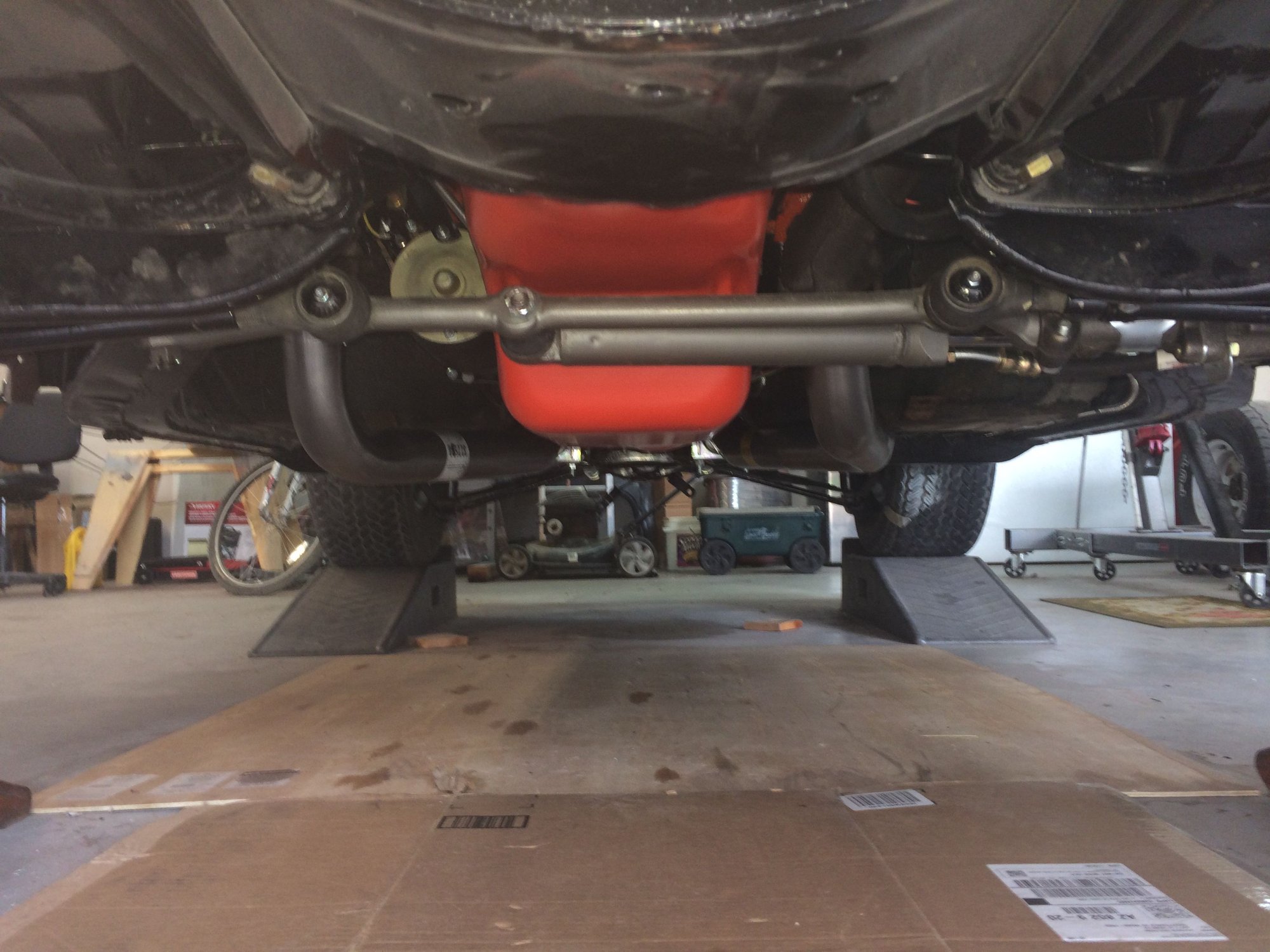

I'm having a hell of a hard time. A project that I though should be pretty straightforward has turned into a real struggle.
I am installing a used but almost new dual exhaust on my '78 SA.
I got the drivers side on with a little persuasion, but it's on. The passenger side has been a nightmare. The pipe doesn't seem to line up properly.
My fear is that I have the pipes that come off of the manifolds on backwards. There are only 4 pipes, the two that go to the mufflers are easy, the two off the manifolds could be wrong because they are similar. I DONT want to have to tear apart the drivers side, but if they're backwards, I have no choice.
Does anyone have pictures from the underside of the car attaching to the manifolds?
Here is the one I'm was trying to get on to the passenger side. Can anyone tell me by looking at this if it's a drivers side or passenger side pipe?

This is a 74 dual exhaust system very similar to the one I installed on my 77. The pipe that you show in your post looks like it belongs on the driver side. In the above pic it's easy to see how the front pipes are bent to pass through the crossmember.

I'm almost positive that I have them backwards.
The bend should go in not out.
Does anyone have a picture of their exhaust from underneath at the manifold?

Hard to tell from these pictures but thanks for posting them. I think mine are backwards. Damn.
Old Aug 26, 2017 | 07:36 PM
Norcoastal's Avatar
Norcoastal
Joined: Jul 2017
Posts: 231
Likes: 15
Actually looking closer you're right. Thanks again!

I absolutely had it backwards. I took out the drivers side that I already installed and switched the pipes off of the manifold.
Funny how the exhaust pipes seemed to slide right into place when I did that.
