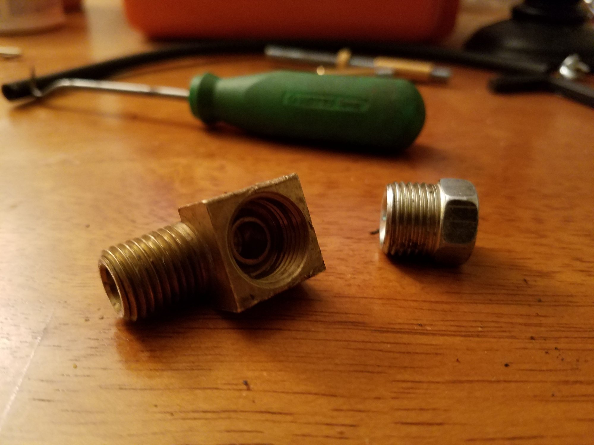

This is one of two fittings (the other is on the car is leaking) I purchased from Dr. Rebuild and the other from Zip corvette. The male end of this fitting and the one on the car is 1/4 NPT and it leaks when you fasten it to the feul pump body. The fitting on the right is the one at the flared end on the 3/8 brake line I used to fasten to the female end of the brass fitting this crap leaks as well.
This is a fuel pump from Advance Auto. (my pump is still on the car) Are the threads on this opening and the pump on my car NPT as well? This crap is frustrating. Buying parts that don't work. If this is wrong what type of threads are supposed to be on this fitting?

The pump and fitting look correct, npt threads need to have either pipe dope or teflon tape to aid sealing. Although the inverted flare seals on the flare, it sometimes helps to put teflon tape on the threads of the nut, this helps to reduce friction so the flare can compress more.

Did you flare the line yourself? Look at it closely, sometimes they split in the flare. The new brass fitting may help if the old one has been over-tightened before. Maybe a good flare nut wrench and tighten the ---- out of it!

That fitting on the new pump does not look like an inverted flare. The 90* fitting in the picture above it looks like a female inverted flare.
(My 69, the pump is also a female inverted flare. I fabricated a 3/8 line to fit. )
Not sure who makes this feul punp. The one on my car is by Airtex. The fitting welded on the pump body on my car is not an inverted flare. Im sure none of them are regardless of the manufacturer.
The male end of the brass fitting leaks after being tightend to the pump and the female end if the brass fitting that the flared end of the brake line leaks as well. I used this pic to show on the 79 what I was talking about. Also the fuel pump on the 79 is longer than that on the 69 (it that makes any difference)
